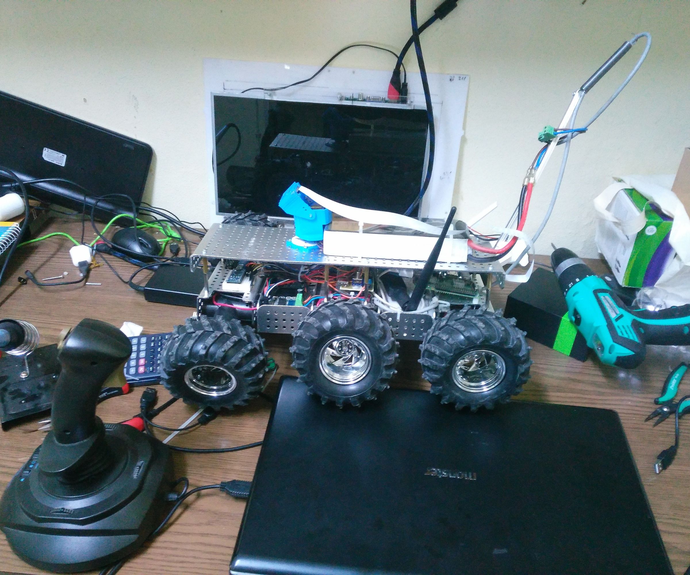

PURPOSE AND TASKS:
- Arduino was used for motor control.
- Arduino and Raspberry Pi were connected by serial communication.
- Before PWM signal interval which will be sent from Android phone to Arduino don't transfer, this signal was calculated. (Because of the next updates and easily interfere to PWM variable by users.)
- The Raspberry Pi provides the Wi-Fi communication with Arduino and the user (Android phone).
- In the following section, we show the circuit schematic for Raspberry Pi, Raspberry Pi Camera, Arduino, L298N Motor Driver, motors and batteries.
SETTING UP ARDUINO AND PIN CONNECTION SCHEMATIC
- Data which come to Arduino is sent as a PWM interval that go to the motors directly. There are two values + (forward)or - (backward) for decide direction with PWM value.
- Above-mentioned situations is considered by us, there can be made various modifications.
- PWM interval is between0-255.
- RIGHT AND LEFT motor PWMs' and servo motor angle is taken as a String(e.g. 200:200!888) from phone. This String value is splitted with : and ! characters and created the array that has 3 elements.
- The value after the ! character is the servo motor's angle value which connected with camera. Servo motor is not used in this project. Motor Moving, PWM data and situations of the car
Example:
0:0 //stop
200:200 // move forward. (2 motors work with 200pwm)
200:-200 //move backward. (2 motors work with 200pwm)
200:-200 // left motor turns 200 pwm to forward, right motor turns 200 pwm to backward (The car turns its around from left to right.)
200:-200 // left motor turns 200 pwm to backward, right motor turns 200 pwm to forward (The car turns its around from right to left.)
200:100 // The car moves as turning to the right.
- Connections among Arduino, Raspberry pi,Raspberry pi camera module, L298N motor driver, Motors and Power Supply are set up as above picture.
