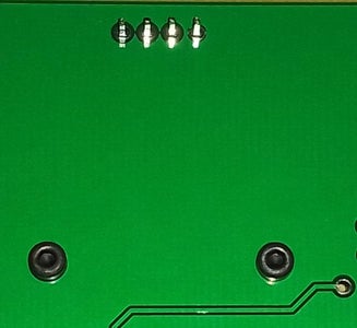

Step 7: Solder the 128x64 Monochrome OLED Display
Since it is the most fragile part, the OLED is the last component to be soldered. Before soldering the OLED, first attach the 3D-printed spacer to the OLED using two M2x4mm screws as shown, then attach the OLED and spacer to the board with two additional M2x4mm screws from the back side of the board. Be careful not to over-tighten the screws or you may strip the threads. The OLED should now be aligned and held in place for soldering.
As previously noted, pins connected to the ground (GND) plane it will require more heat in order to make a good solder connection.
