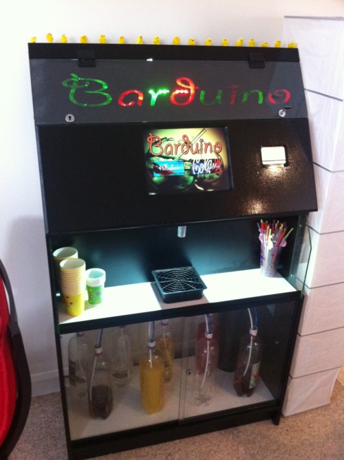

Step 1: Choose / Make a Cabinet
First thing is to find a suitable enclosure for the valves, arduino, CO2 and computer. This will depend on where you want to use the bar etc.
The principals remain the same for all cabinets, valves with tubing controlled by an arduino with associated electronics. The cabinet will determine the length of tubing and connectors required to get the drink to dispense where you want it to. See our photos for an idea of the tubing and connectors.
We chose an Ikea cabinet to minimise the amount of wood work needed. The cabinet needed minor alterations and also a housing needed to be created to hold the touch screen computer.
Step 2: Wire the Valves – Tubing and Electrical
The valves need to be powered by a 12v supply. The supply is
controlled to each valve independently by the Arduino. The pattern in which they are turned on depends on the drink ‘recipe’ which is contained in the SQL database. The windows app reads this from the SQL database and sends the pattern to the arduino which in turn powers the relevant valves.
We are by no means electrical experts so the board we created is probably not best practice but it comprises of resistors and transistors ( high power ones ) which take a 5v input from the arduino to control the valves.
All the tubing we bought used push fit connectors to allow for easy disconnections and cleaning etc. The valves themselves were ordered from eBay at a cost of £3 each. The bottles are configured so they are under constant pressure from the regulated CO2 supply, when the valve opens this allows the liquid to exit.
The tubes from the valves terminate onto a standard 2L bottle. The tubes are passed through the threaded cap and sealed using hot glue.
The drinks are then dispensed from the tube which is illuminated when a user is logged in.

The protocol is basic and could probably be improved. It basically sends the string of what valves need to be opened encapsulated in <> eg:
<4455> will open valve 4 twice and valve 5 twice. The valves are opened for a pre determined time which is based on a shot measure. This varies based on the pressure so you would need to time this based on your setup to get an accurate measurement.
