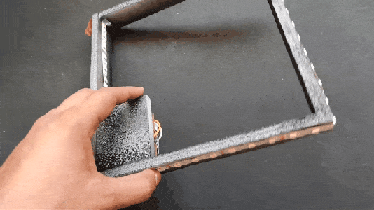

Here we make two things, one is the base of the circuit and LED, and the second is the pumpkin.

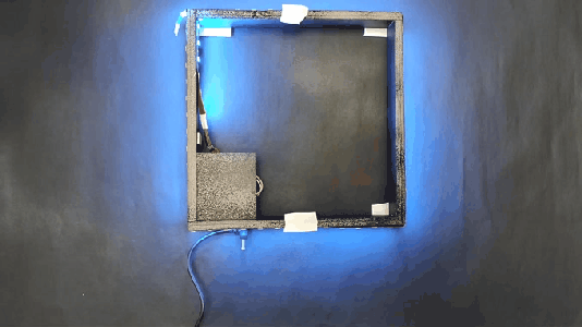

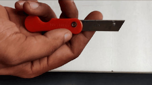

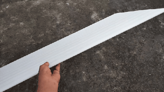

First of all, we make the base of the circuit and LED, to make this, cut the equal size of strips as shown in the image. You can cut it with a paper cutter or you can use a hot wire to get a perfect cut. Stick four strips in a squire shape as shown in the image, you can see a piece of small squire at the corner of the big squire it is to support the circuit. This part will hold all LED strips along with the circuit which we will do in the circuit part, for now, let’s build a pumpkin from foam board.

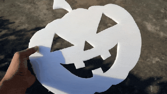

AS you can see in the image, Cut a pumpkin shape out of the foam sheet. As I said cut it with a hot wire or paper cutter. The easiest way to cut it is, draw the pumpkin on the foam sheet and slowly cut the shape.
After cutting the Pumpkin out of the foam board, I found that the light passes through the foam board, so I cut a black sheet same as the foam sheet, and placed it on the foam pumpkin with help of glue.

Once everything is done stick the led strip on the squire base, which we made from foam board. You can see there is a circuit on the corner.
Stick it on the wall with help of some double-sided tape, you can use nails if you want. Now place our pumpkin head on the base.

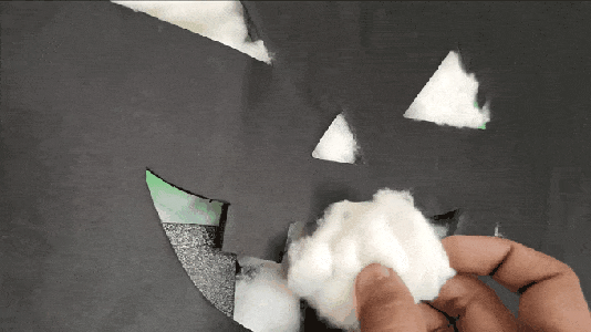

I have added some cotton to it to diffuse the light inside the pumpkin and white cotton looks good on it.
