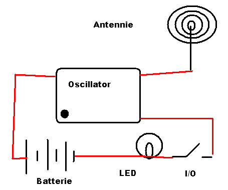

Step 3: Assembling!
If the Writing is confusing, Look at the picture
First, get your Oscillator
On it you will see 4 leads
The locations of the leads in () will tell you the location looking at it RIGHT SIDE UP, meaning that the righting will be right-side up, and the lead with the black dot will be the bottom left, and the square corner instead of the rounded corner will also be bottom left.
1 lead (bottom left), the one with a black dot on it, and it also has a square edge instead of a rounded one is Only to hold it on the circuit board and does not need anything attached to it (It shouldn't be attached to anything anyways).
the lead diagonally across from it (Top Right) is to be connected to the antenna.
The two remaining leads are for the voltage source.
The Top Left lead is connected to the +ive end of the battery. The Bottom Right lead is connected to the -ive end of the battery.
Look At the picture
Step 4: Now That Your Done!
Now that your done the wiring.
You can solider it to a circuit board (optional)
Turning On the jammer will send out an EM wave of X (X is the frequency of the Oscillator)
Tun on the oscillator and... Nothing
You have successfully jammed a radio signal!
