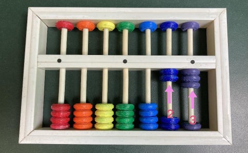

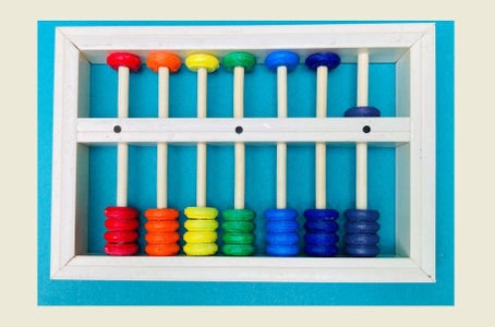

This Rainbow Abacus consists of seven rods and 35 beads painted with the seven colors as that of a Rainbow.

Insert a pipe with beads one by one through the holes. Above reckoning bar (middle bar) insert one bead and below it insert four beads. Take the help of images.
Make three black dots on the first, third and seventh bar having its own significance.
After inserting all pipes, join the bottom duct of the frame with the help of superglue.
Now that’s all. The Rainbow Abacus is ready to use.

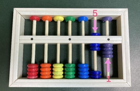

Step 6: Calculation/Working
Example 1:- Representation of digits 23 on the PVC Abacus.
Just slide two beads on the ones and tens place to the reckoning bar.

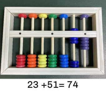

Example 2:- Addition of two numbers 23 and 51
Input your first number by entering 23 on the abacus by pushing up three beads in the ones place, two in the tens place. Now enter the second number by pushing up one bead in the ones place and pushing tens bead (value=5) above to Reckoning bar.
Count your beads to get the answer:- 23+51 = 74
