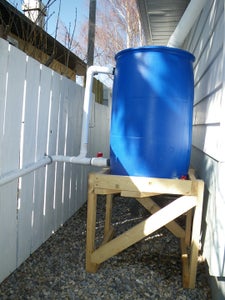

This is a custom system I designed to collect the rainwater coming off my roof and have both the ability to store the water and distribute it without attaching any temporary piping. My apologies in advance that I don't have pictures showing the step by step construction - I only discovered this site last night!

Step 2: Build the Stand
I didn't have any set plans, but I knew I wanted to build something that wouldn't fall apart under the weight of the water-filled barrel. A 55 gallon barrel of water weighs over 200 kilograms. Also, if the base sags, the connections will be stressed, so make the base of the legs wide to support the weight.
I built mine out of 2x4's, roughly 2'x2'x2'. The barrel I purchased (side note - these can be obtained quite inexpensively, just make sure what they used to contain wasn't toxic) had a spigot attached, so I had to accommodate that during construction. I had to be careful to make sure the lengths were correct (measure twice cut once), and that the joints were square. Take a bit of extra time and it will stand up much longer.

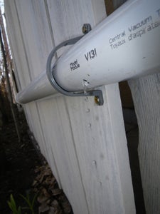

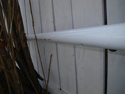

Step 3: Prep the Pipe
In this step I prepared the lengths of pipe by drilling a 1/2" hole every foot along the pipe - be sure that they are all in line.

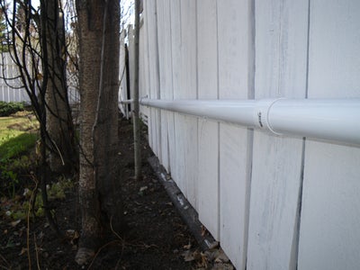

Step 4: Determine Your Fall Line
I have a 40' section of fence I wanted the pipe to travel, so I put a screw in the fence at the level the water would be exiting the barrel, and then a second screw in the fence where the pipe would end. I then took a string and attached it to both strings to find out what the fall would be from the barrel. From this line I put marks on the fence where I would attach the pipe using the straps.
Step 5: Attach the Pipes to Fence
I attached the pipes to the fence with some plastic 'C' shaped straps - found them in the electrical section of the hardware store. Then, using the ABS/PVC glue I connected the end cap, and then pipe-to-pipe with couplers - almost all the way back to the barrel.

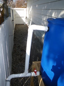

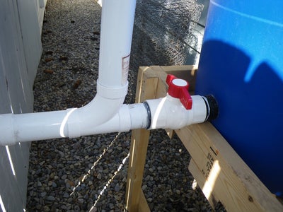

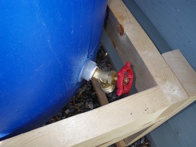

Step 6: Plumb the Barrel
This step proved to be a bit more complicated than I expected, mostly because I was using vacuum tubing/connectors on one side, but to connect to the barrel the only pieces I could find were for plumbing. Problem was, they were about 1/16th of an inch smaller than I wanted them to be. So after a bit of cleaning out the inside with a dremel, I was back in business.
I designed this system to be able to store rainwater, but have a spillover pipe that would take any excess into the pipe system and away from the house. This spillover pipe enters the main pipe on the opposite side of the valve (see pictures).
I cut holes in the barrel, as I was concerned that the small spigot wouldn't be able to handle any volume of water. I then attached the plumbing fixtures at the top and bottom and used some silicone caulking to seal the connection. I then measured, cut, and glued the pipes, elbows, and valve assembly.
Step 7: Connect the Valve Assembly to the Watering Pipe
Pretty straight forward - helps to have a bit of leeway in your watering pipe (the one you drilled holes into). Use couplers if needed and the ABS/PVC glue.

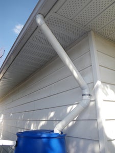

Step 8: Connect to Your Eavestrough
I did this step a day after I did the other steps, and from one day to the next I learned that the 2" pipe capacity was just barely enough to handle any real volume of water coming from the barrel. So, I opted for a 3" diameter abs pipe to handle the water coming from the roof. It was a little tricky getting the oversized fixture to attach to my aluminum eave, but with some minor modifications I got it to work. Again, I used some silicone caulking to seal the connection.

    Calculation is correct Hugh - or in kilograms (as I'm in Canada and we use the metric system) it's 206.9742kg
    Side note: the stand continues to hold strong after 5 years of use and being exposed to the elements. I've revised the design to have the cross boards on top of the supports, which in turn are on top of the legs.

    I have a feeling that your fence will begin to rot where the holes are made in the piping. Water takes the path of least resistance, hence down along the side of your fence.
    0
    mark11photography
    mark11photography
    Reply 7 years ago on Introduction
    Hi Shooglenifty - I had the same concern when I set this project up 4 years ago, but have found no such problems with the design. My experience has shown that rot tends to form when water comes into contact with wood without the drying presence of air. We live in a very dry, not exactly desert, climate on the eastern slopes of the rockies, and don't have much rot issues aside from where the fence boards are in touching the ground.

    Righteous instructible! I was just wondering what the purpose of having the pipe fork into the one pipe leading to the greenery?
    0
    mark11photography
    mark11photography
    Reply 10 years ago on Introduction
    Jimi,
    Very simply, the top pipe you see acts as a safety overflow. When the barrel fills to that point, it automatically drains to the free side of the valve and away from the house. One of the reasons I installed this in the first place was to avoid water from the downspout collecting and leaking into my basement. And after two years I can say it works perfectly.
    Thanks for the feedback!
    Mark
