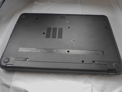

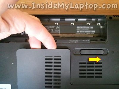

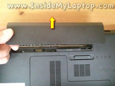

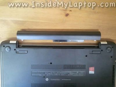

  4. Remove the battery by sliding the two latches to the left
  5. Make sure the bottom of the laptop is facing upward

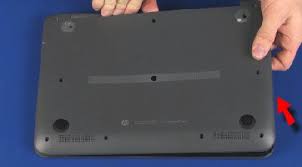

Step 4: Removing Back Cover
With the small set of screwdrivers remove the screws from the back panel. Then remove the inner panel to reveal the location of the ram.

  • Push the battery in its slot until it clicks
