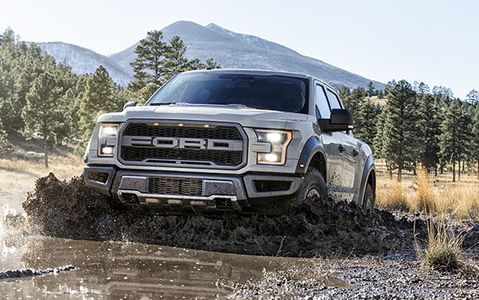

Have you seen the Ford Raptor driving around, or on a video somewhere? One of the things I like about those Raptors, is the sharp looking LED lights. I have a 2005 F250 Superduty, and thought to myself, wouldn't it look cool if I could have those 3 LED clearance lights in the grille, just like the Raptor? Well that got me thinking, what would be the easiest way to accomplish this? I could do a couple different things, I could try and find some real Raptor LED clearance lights somewhere, I could buy a clearance marker light bar for a trailer and mount it behind the grille... Oooorrrrr, I could do something cool, and make them from scratch. Obviously I chose the last option, otherwise we wouldn't be here... as with every instructable, do this at your own risk, I am not responsible for any damage or injury occurring as a result of trying to replicate this instructable.
