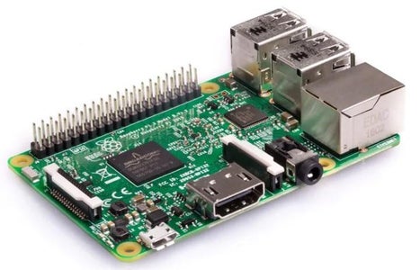

Raspberry Pi - the more modern the better.. but I use a 3b - and it's good to go.
