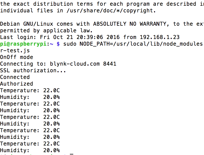

Now run it:
sudo NODE_PATH=/usr/local/lib/node_modules node ./blynk-sensor-test.js
The output should look like this:
OnOff mode Connecting to TCP: cloud.blynk.cc 8442 Connected Temperature: 18.0C Humidity: 26.0% Temperature: 18.0C Humidity: 26.0%
Note:
- You need to run our script with sudo as the sensor library requires privileged access to the hardware
NODE_PATH=.. is set because Node.js may fail to locate global modules otherwise
Step 4: Enjoy Sensor Values in the Blynk App
Now, check the Blynk App on your smartphone, it should display a nice plot of temperature and current value of humidity. Congratulations! ;)
