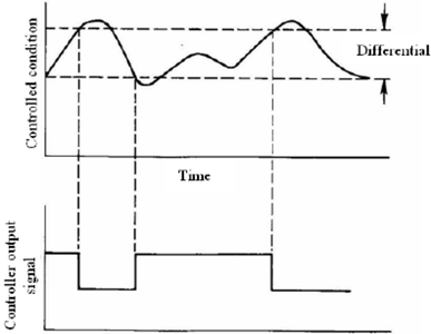

The controller that we will deal with, the simplest one, is the ON-OFF controller. In this type of controllers, the output will be activated whenever the process value is under the setpoint. And after the process value reached the setpoint, the controller will deactivate output. There is a variable here which is called differential value. The controller will be ON again whenever the process value comes under the (Setpoint-Differential).

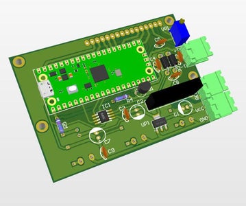

Step 7: Printed Circuit Board
After I tested the circuit on the breadboard, I decided to design a PCB to put all the components on it and make it a solid device. You can download the Gerber files for the PCB below.
