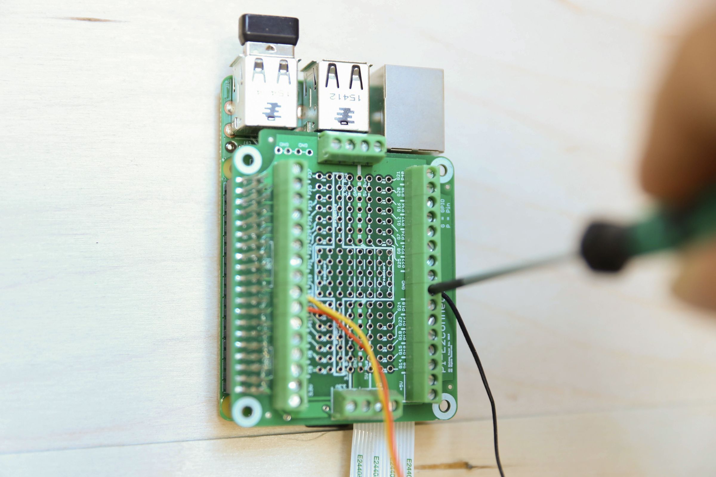

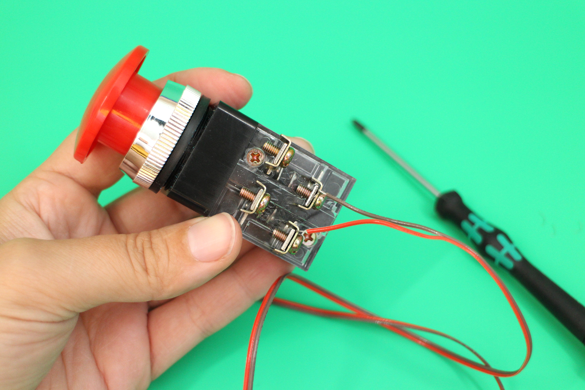

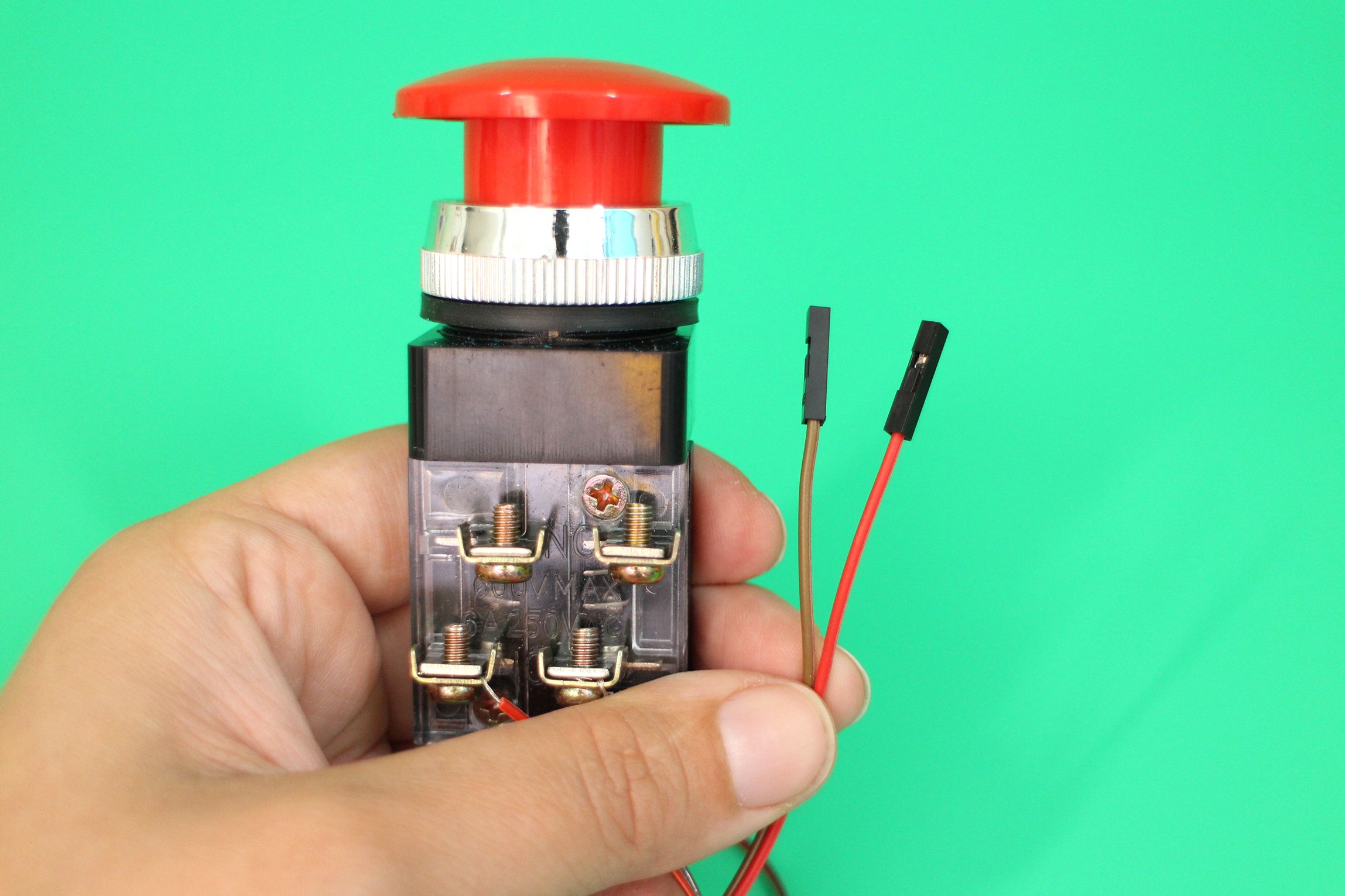

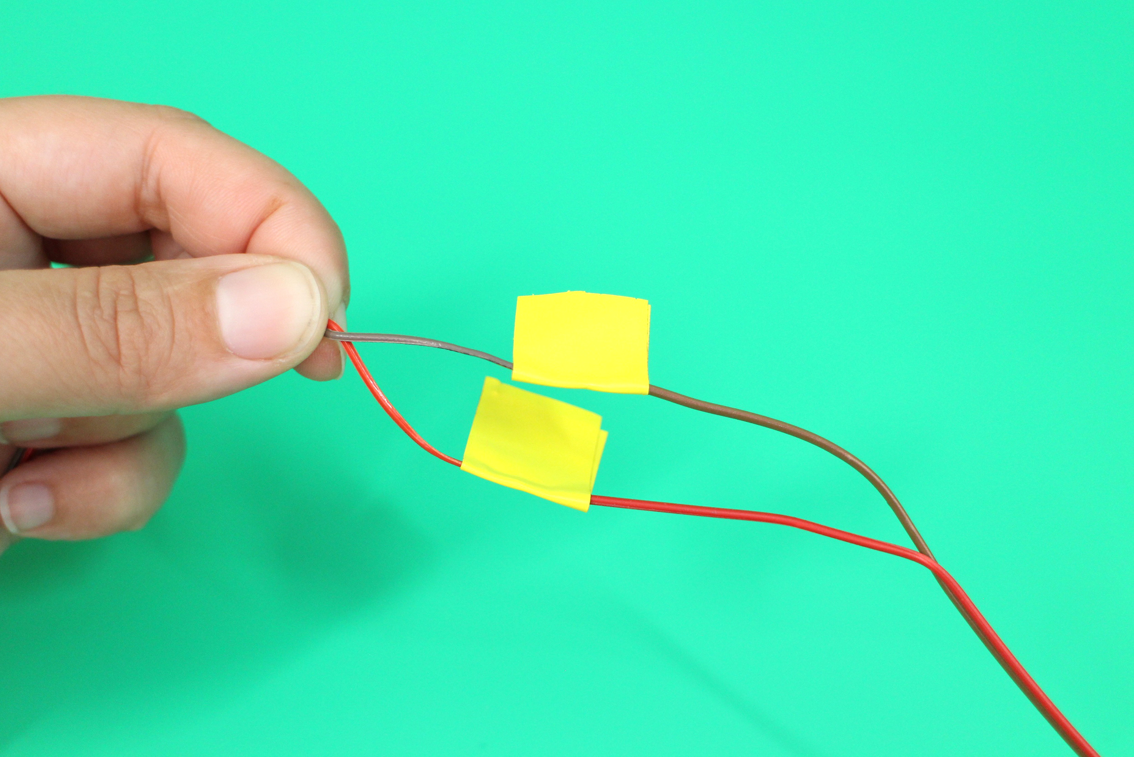

Time to read a switch! First, you need to connect jumper wires to the switch's leads so you can connect it to the Raspberry Pi. The leads on this switch are the two bottom screw terminals.

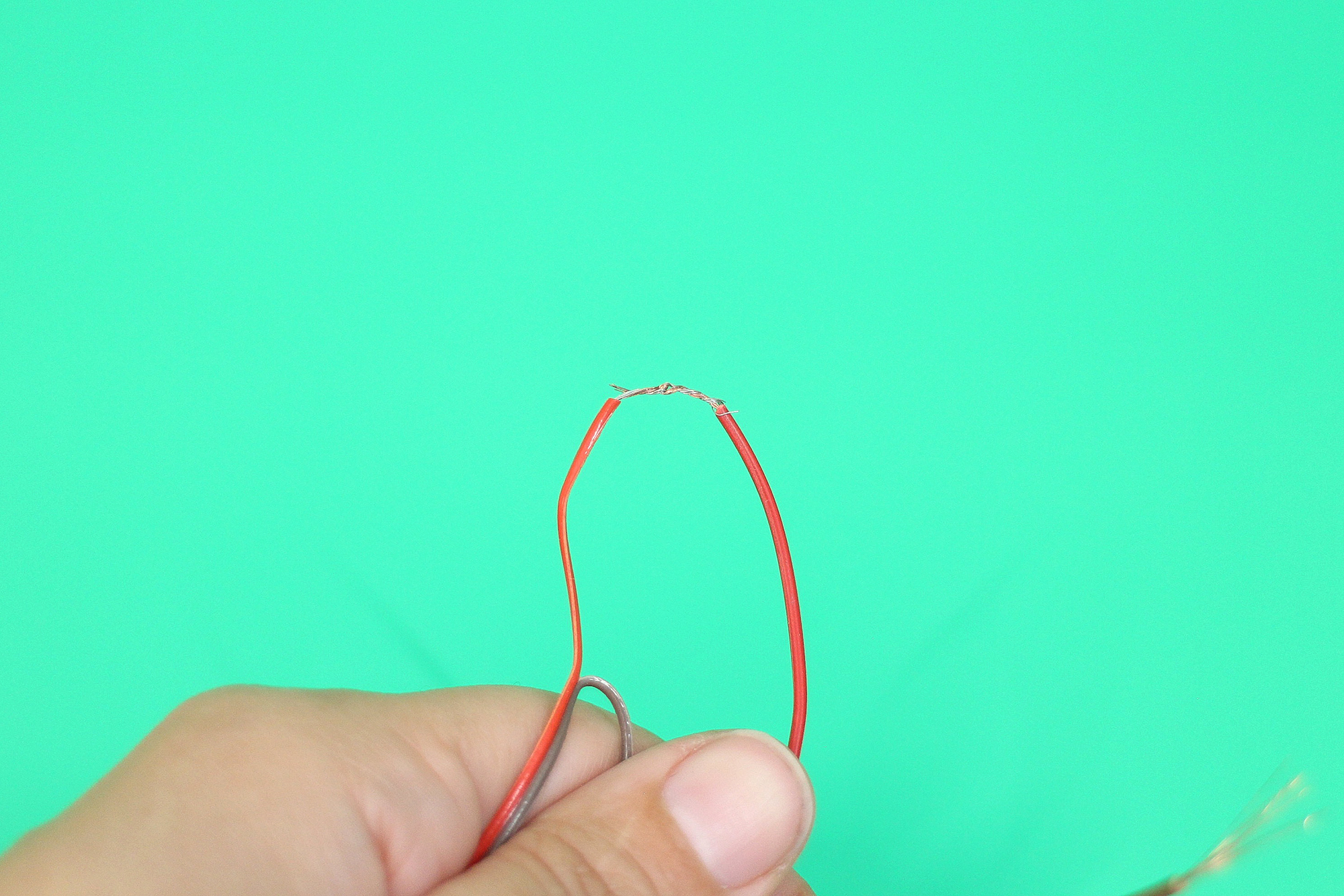

Grab two jumper wires and a pair of angled wire cutters. Make sure the jumper wires each have a female header at one end. Cut off the end opposite the female header and strip the insulation off about 1/2" down.
Use a small Phillips head screwdriver to loosen the two lower terminals on the switch. The goal is to wrap the wire around the screw and to then capture it between the metal plates by tightening the screw. It helps to first twist the small strands of the wire together then create a small hook with the wire to hook around the screw post (clockwise, so the screw tightens the wire around the screw). Once your wires are connected to the switch, connect the switch to the Raspberry Pi as shown in the diagram:
either side of switch --> GPIO 18 (board pin 12)
remaining side of switch --> power pin (either 5 volts or 3.3 volts)
Leave the LEDs plugged in the breadboard; you will use them later on.
To build the final circuit for the photo booth, it needs to be moved from the breadboard. The circuit used is the same as the one from my Raspberry Pi class lesson GPIOs + More Python: one switch and two LEDs. Reconnect the components using either an EzConnect board (terminal blocks) or a soldering iron. You can learn to solder in Randy's Instructables Electronics Class. However, you can also twist wires together and use electrical tape to get the circuit working if that's all you have on hand.

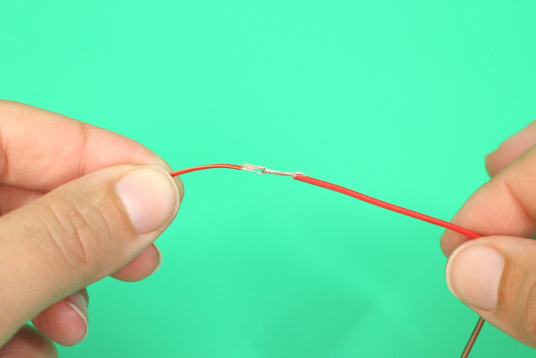

The female headers on the end of the jumper cables slip over the pins on the RPi. To extend the length of these wires, cut the opposite end off, strip and twist around the end of some ribbon wire.
You can plug the components right onto the RPi or you can screw them into the EZ-Connect shield if you purchased one.

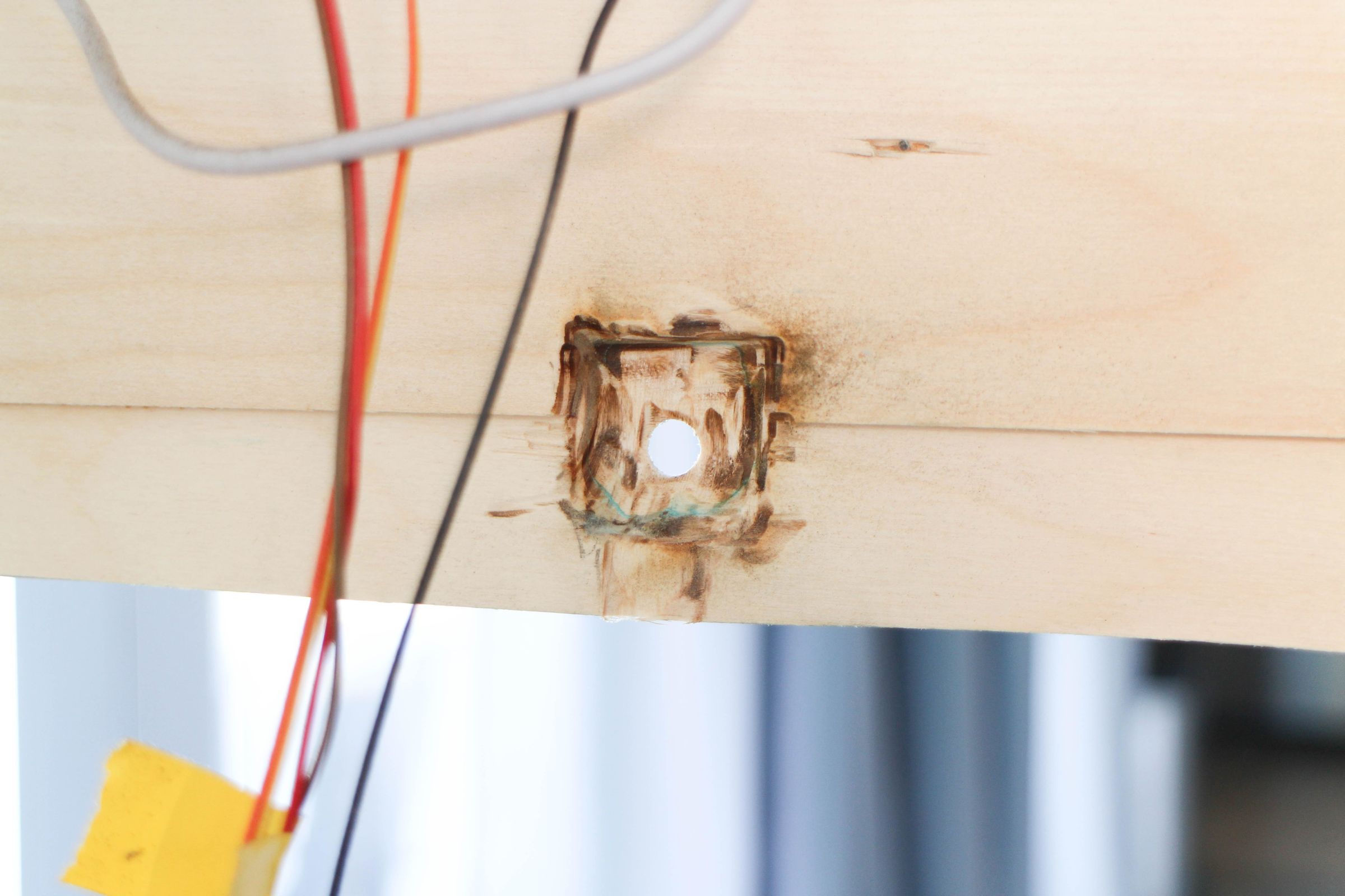

The enclosure can be small, medium or large. The talented Mikeasaurus built a stand-alone facade for this photo booth along with a bench. Four holes were drilled, two for the LEDs, one for the switch, and one for the camera lens. A rectangle was cut out for a 22" screen and a frame designed was cut, painted gold, and mounted. Everything was painted a bright color and vinyl stickers printed to label everything. A small side wall was created on one side to hold an iPad so participants could see their final uploaded GIF.

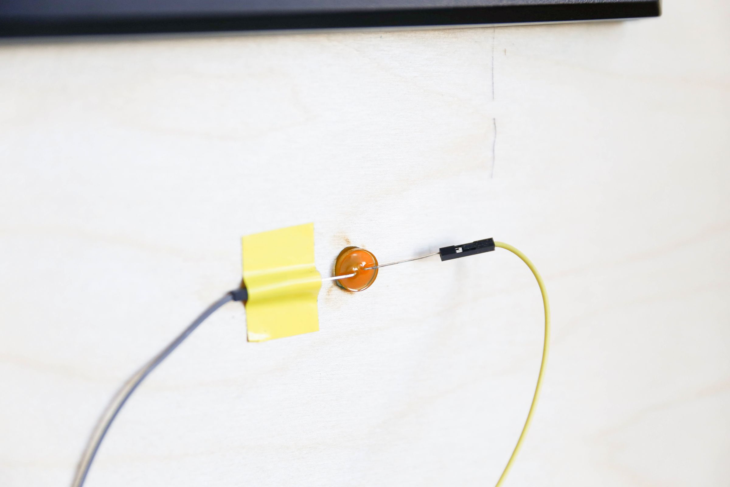

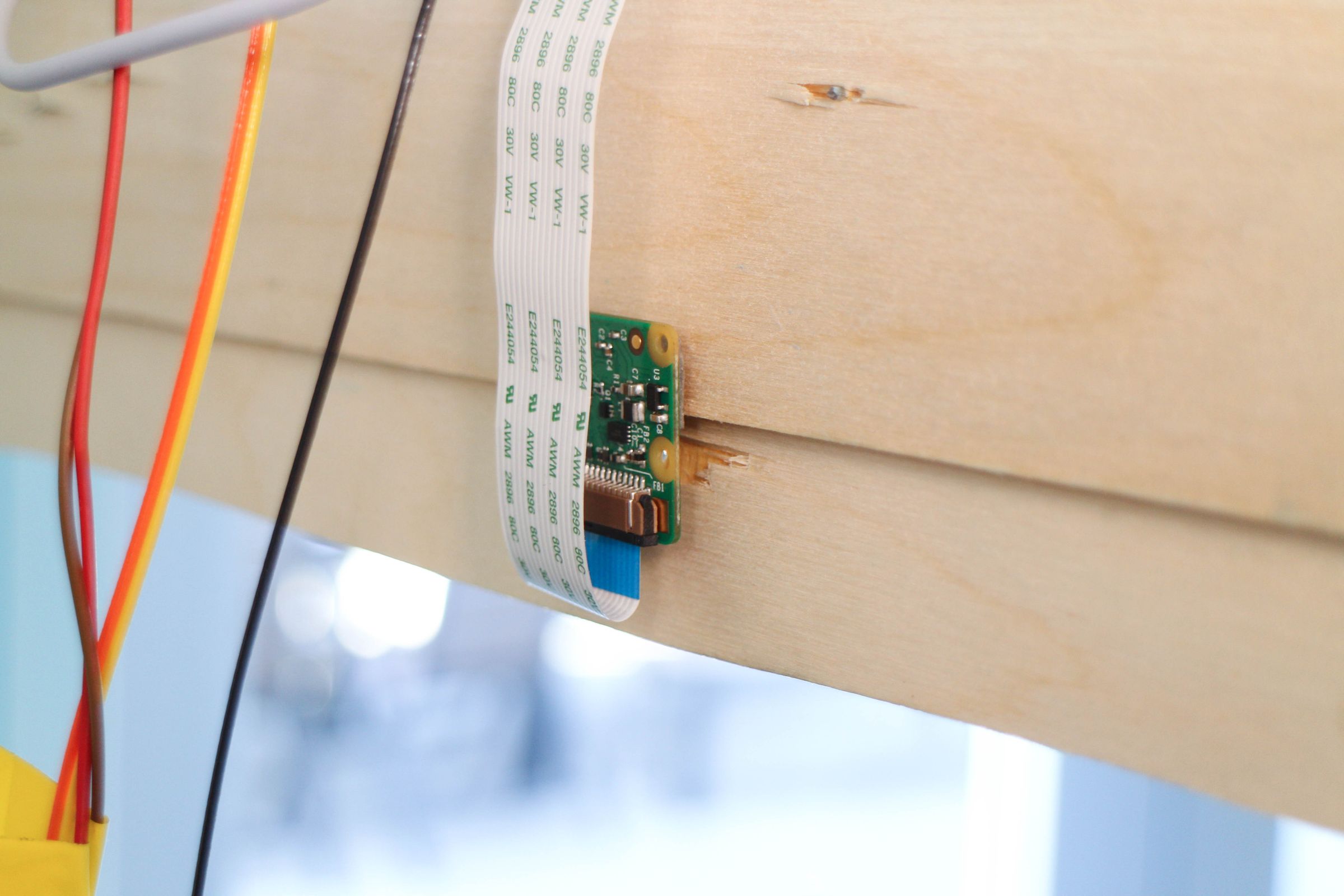

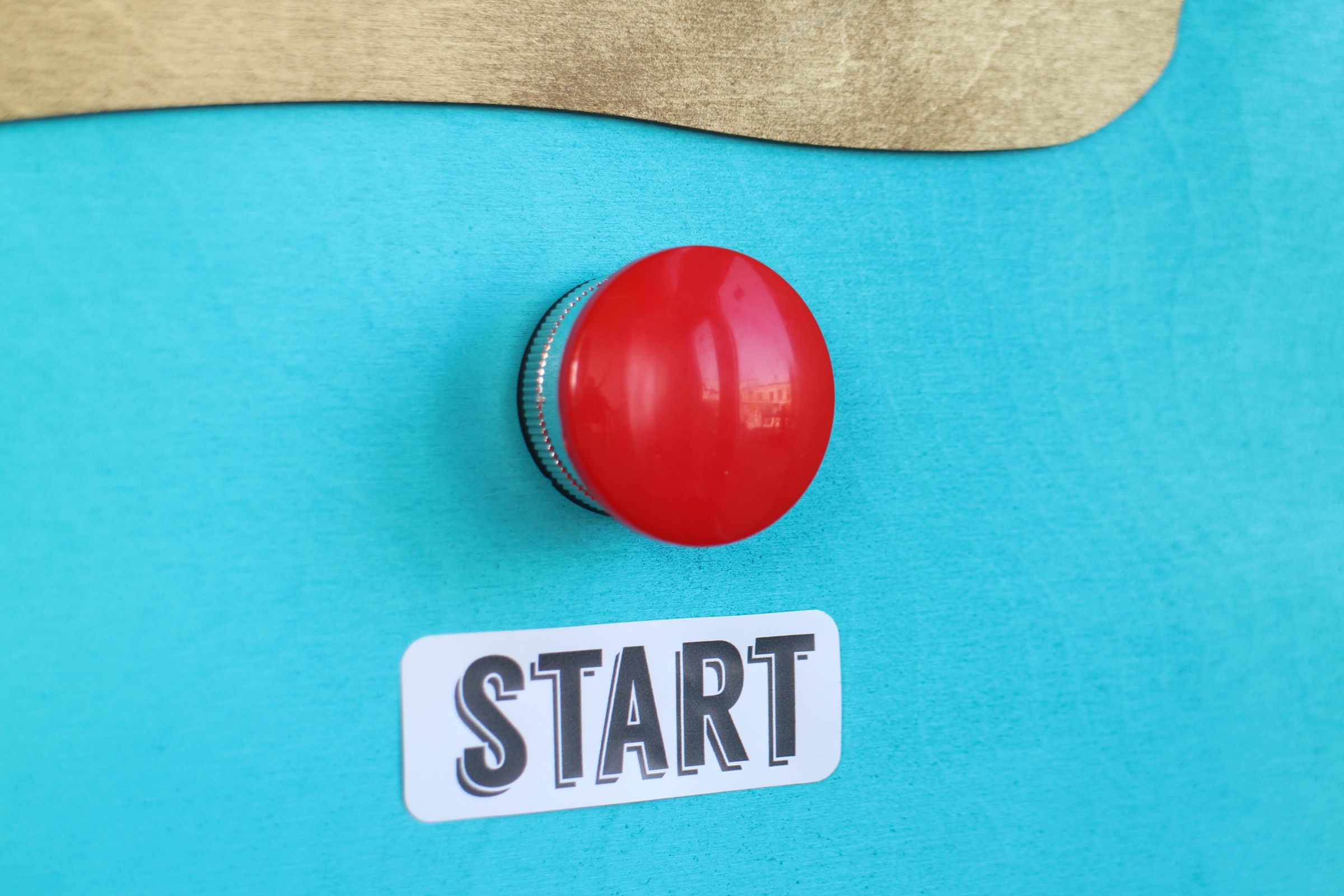

Except for the screen (which has a little clamp to sit in), I mounted everything using industrial strength double-stick tape and hot glue. Make sure the camera lens is close to the surface it's behind. Otherwise, the edge of the hole will be seen around the image. I shaved off the back where the camera is mounted to remedy the situation.

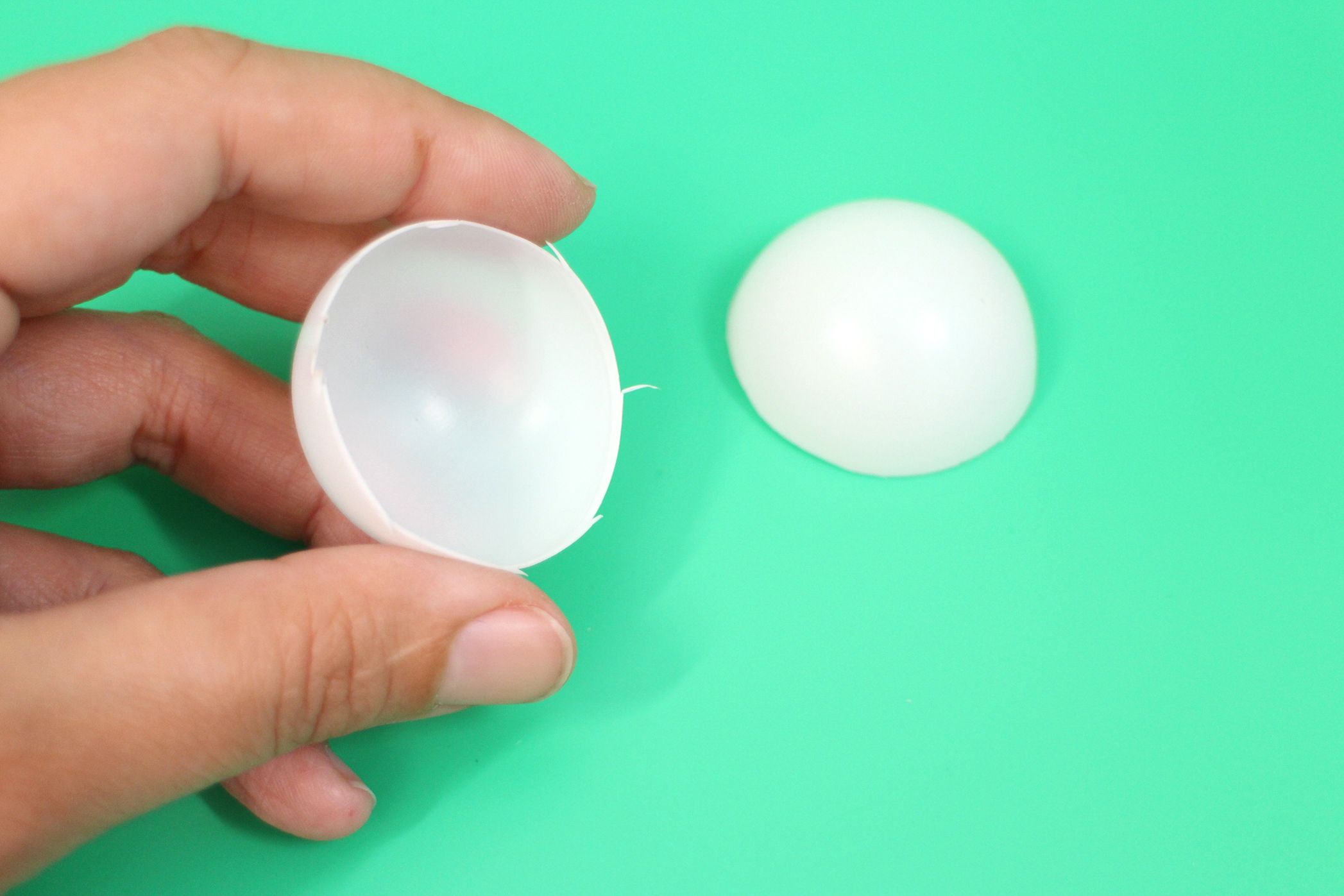

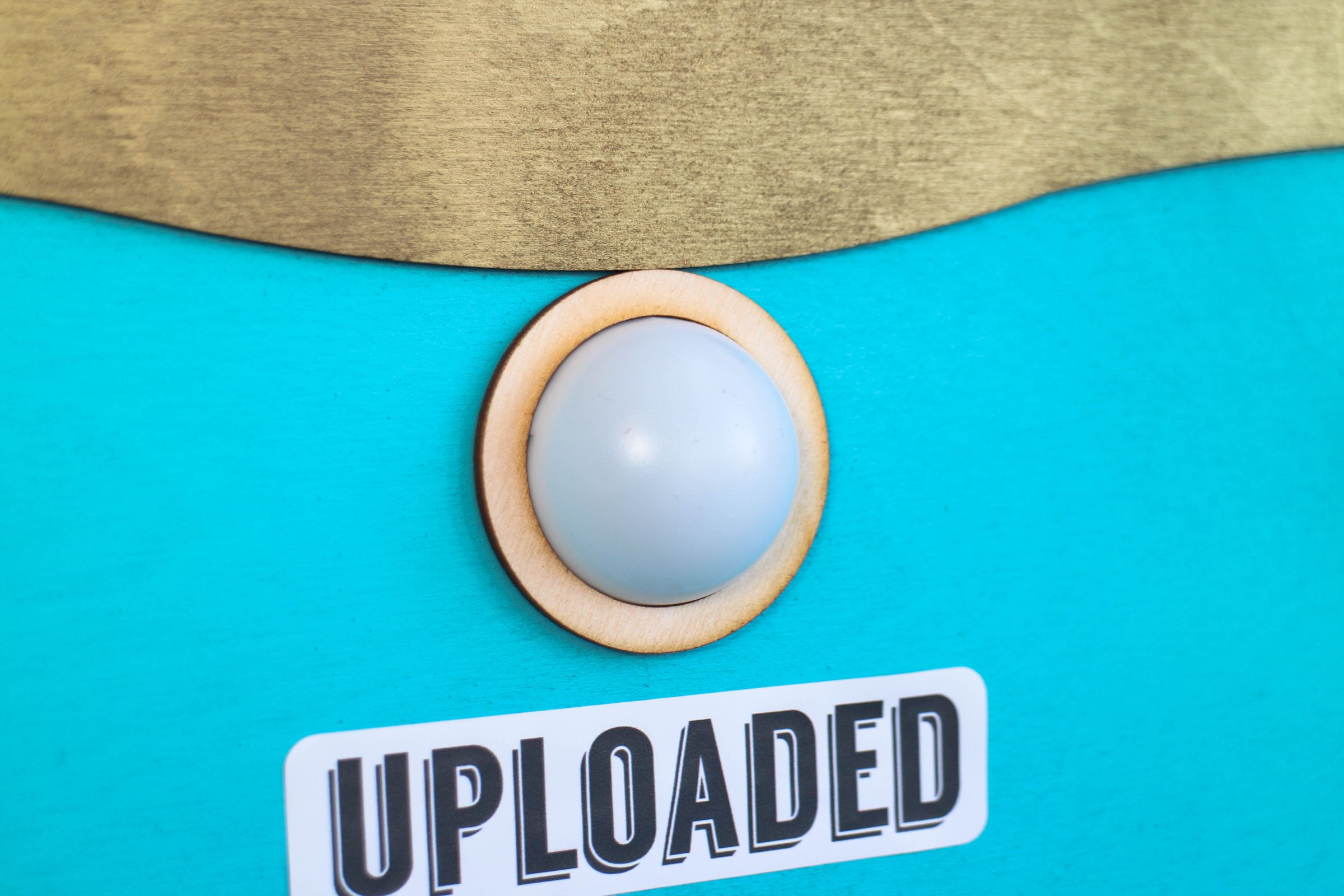

To mount the switch, unscrew the red pushbutton mechanism and silver ring. To diffuse the LEDs, a ping-pong ball was cut in half and centered around each LED hole with the help of two laser-cut rings.

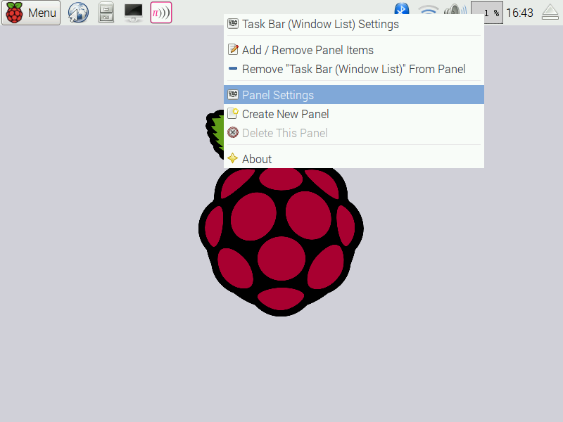

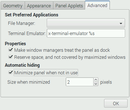

Power the screen and mount and plug in the Pi with a USB AC power supply or battery bank. Once the Raspberry Pi boots, there are a few things you may want to do to clean up the desktop. To remove any icons such as the trashcan icon from the desktop, right-click and choose to remove. To hide the taskbar, right-click on the taskbar and choose Panel Settings. Click on the Advanced tab and tick the box next to "Minimize panel when not in use". Your desktop should now be clear of all icons.
If you mounted the screen upside-down like I did, you can rotate the display by adding a modifying the bottom of /boot/config.txt:
sudo nano /boot/config.txt
Scroll down the file with your cursor and add this line to the very bottom of the config.txt file.
display_rotate=2 180 degrees
Save and exit Nano then reboot:
sudo reboot

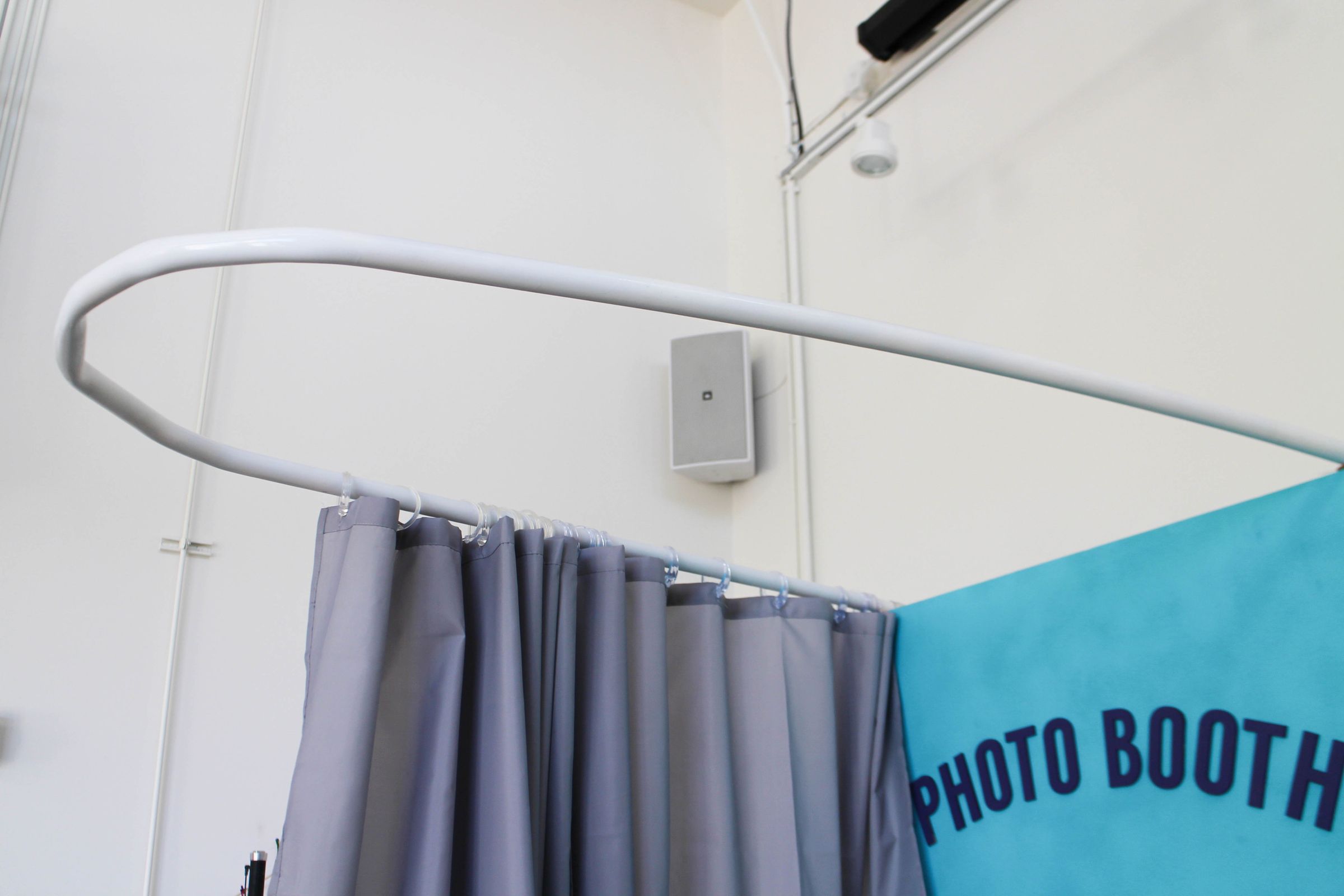

For me, grabbing and pulling the curtain shut is part of the photo booth experience. With Mikeasaurus' help, a PVC pipe was bent and screwed in at the top. A shower curtain works nicely as the photo booth curtain.
