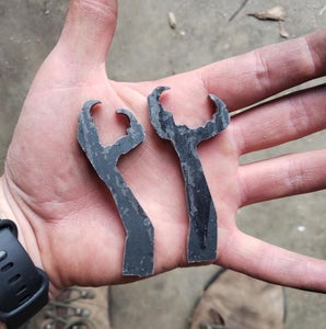

I decided that a pair of bird claws holding up the wand would be pretty sweet, if one of the more complex choices. But after all, what are anniversaries for if not going the extra mile – plus I may have forgotten one or two so I really try now.

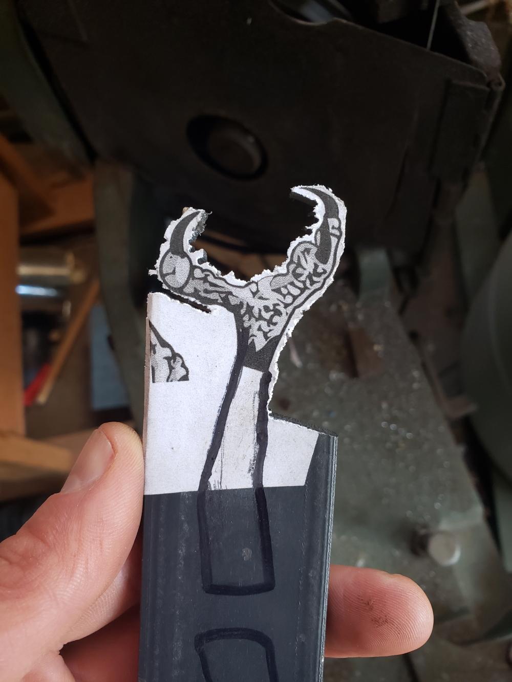

ANYHOW, I searched for vector files that look like something I could recreate in steel and came upon a couple that were not overly complex and could be modified to fit my needs.
I “photoshopped” them (technically I guess I “paint.netted” them but that sounds weird) and removed a few claws/details since I already had ambitious goals and simplifying a bit did not hurt. (See the above for before and after drawings)

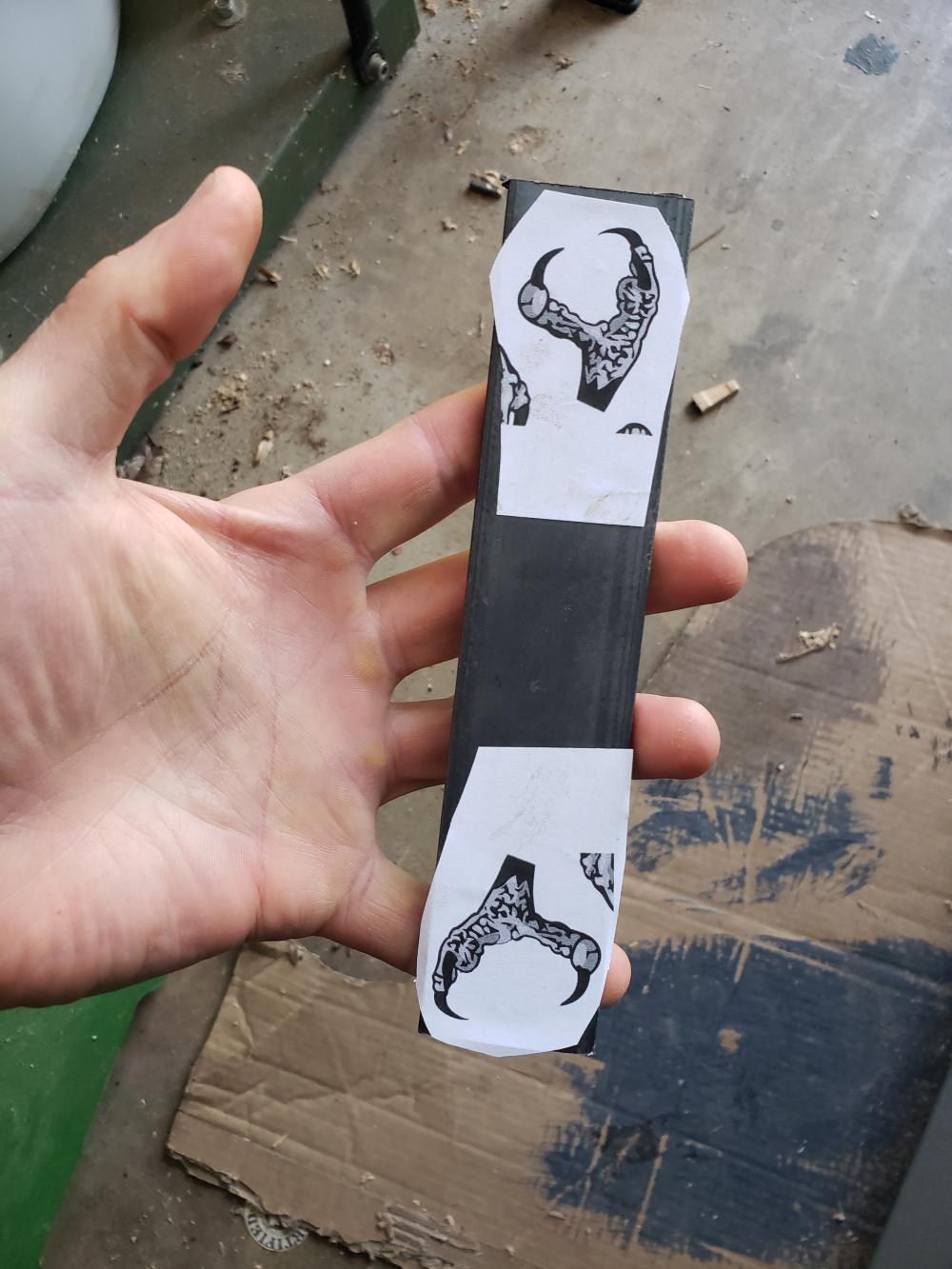

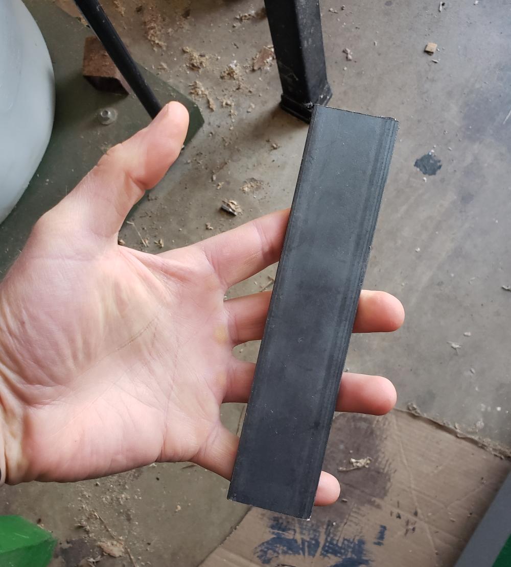

I took them, printed them out, made sure I didn’t leave a copy on the printer for my wife to find and grill me about and glued the claws to a piece of scrap mild steel I had.
Step 2: How Do You Eat an Elephant
One bite at a time.

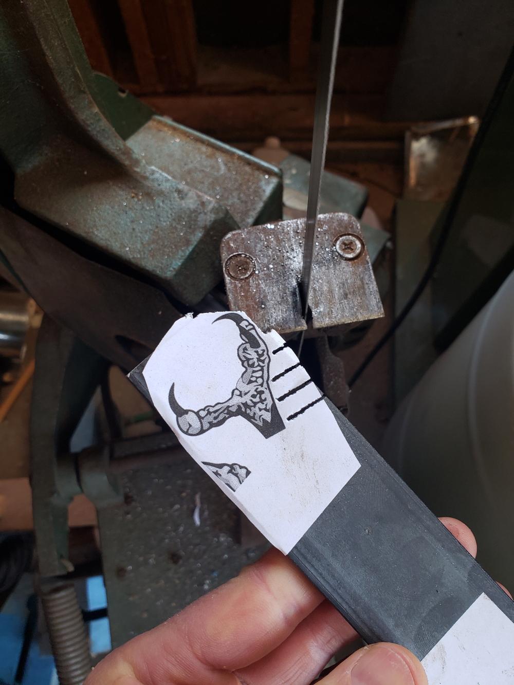

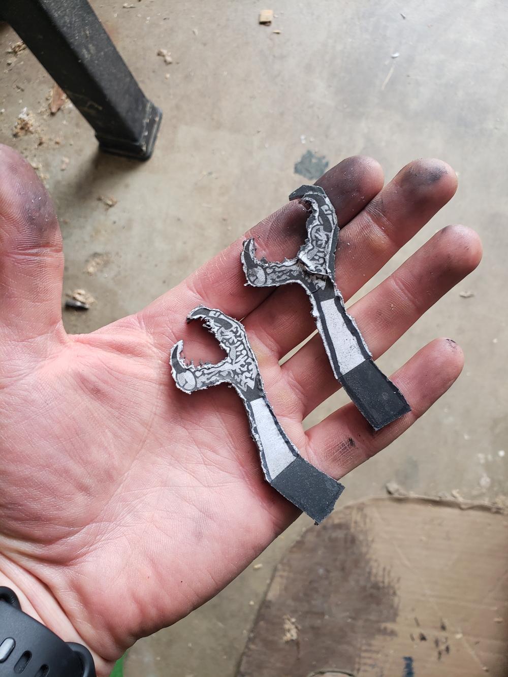

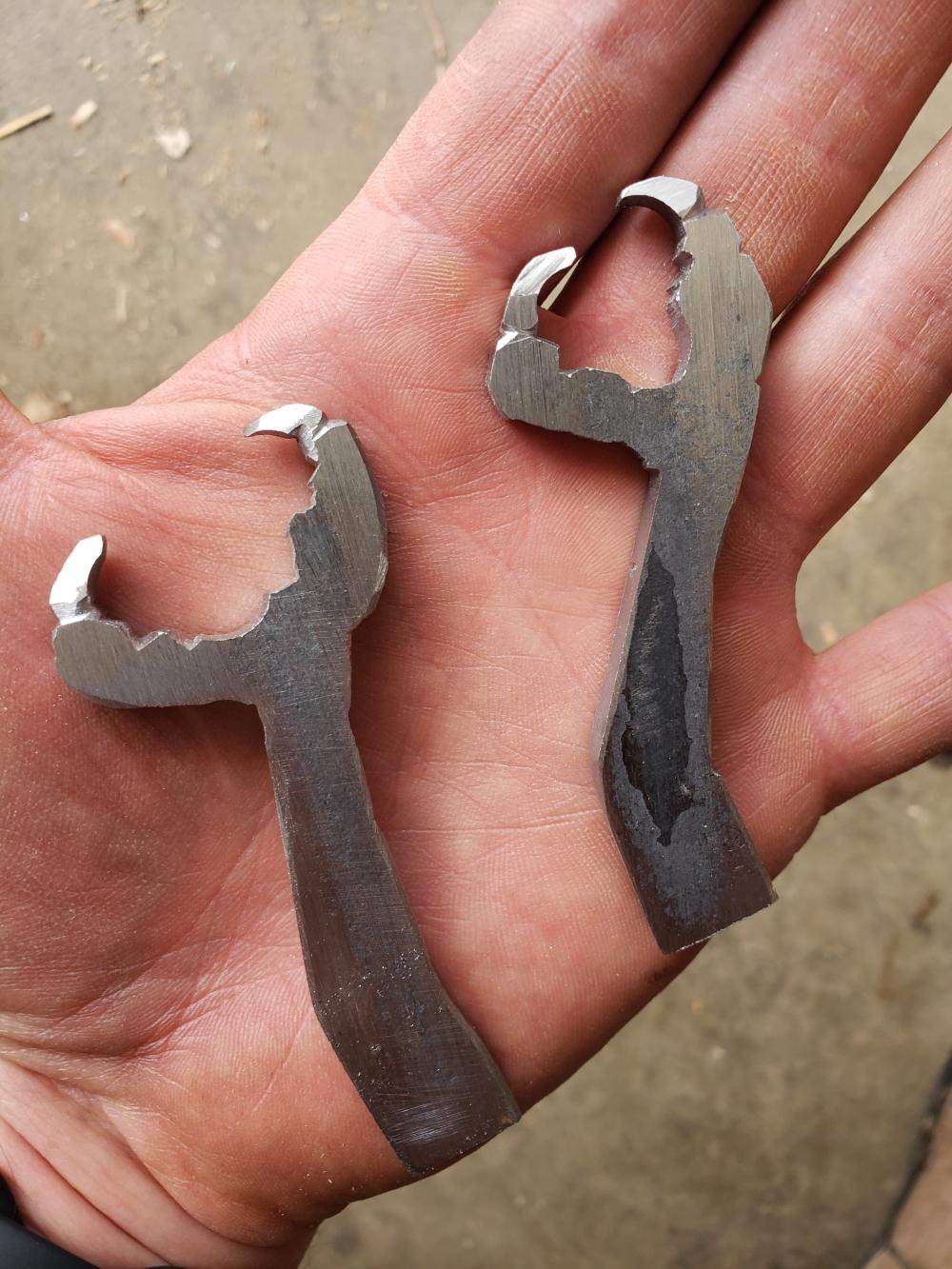

Luckily, I have a decent metal cutting bandsaw. Being so small the claws were pretty trying to cut out cleanly and it took some time but little bit by little bit I got them into roughly claw shapes.
Step 3: Files, So Many Files

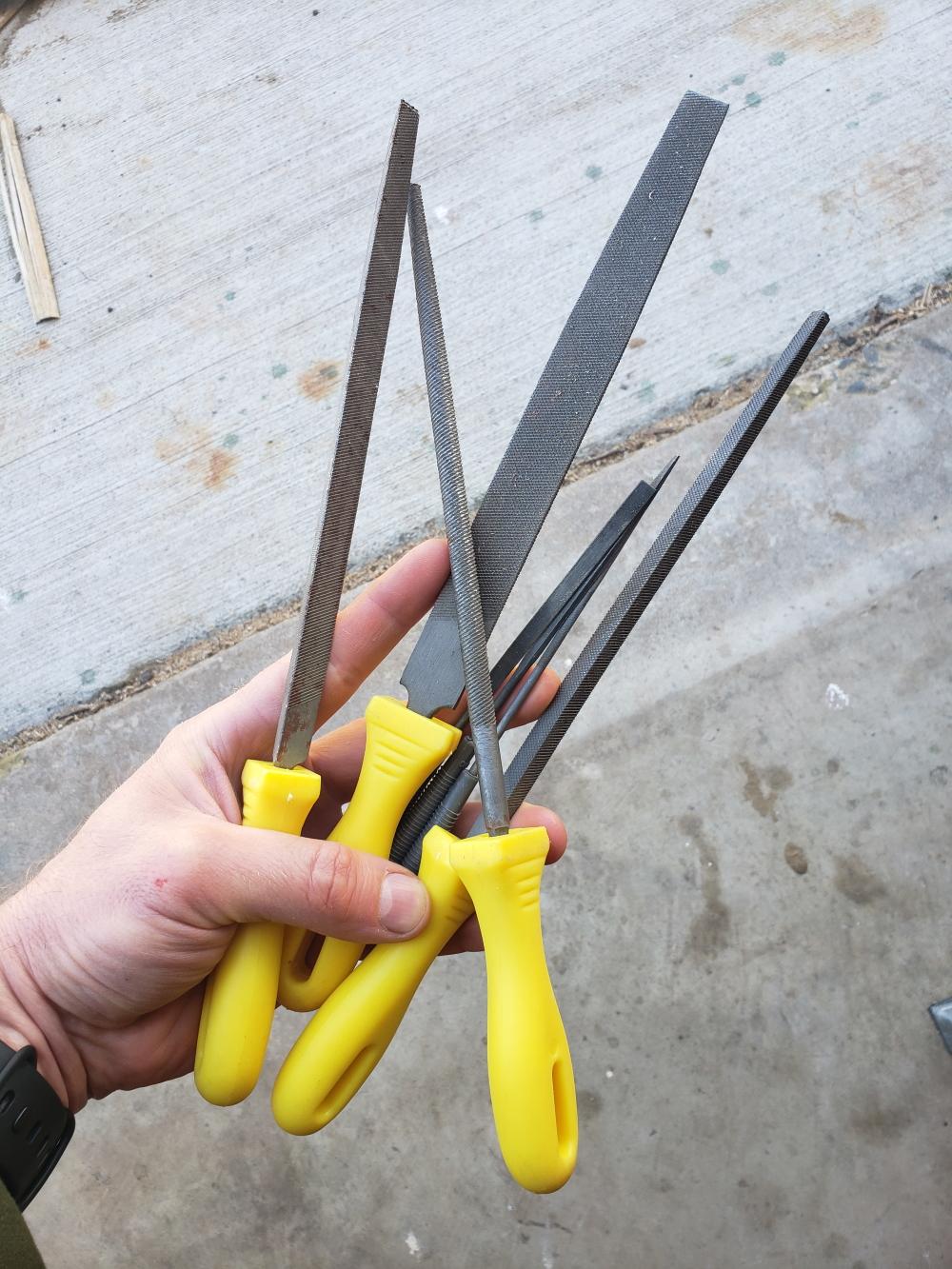

If band sawing was time consuming it was nothing compared to using hand files.
Good lord did this take some time.
It was much quieter though and it helped me work on my patience... which I feel I could use more of.
I suggest a good assortment of files is a worthy investment for anyone who likes to make things from metal. I used primarily a wide flat one, a round one, a smaller square one, and some little needle files, each had the area it worked the best in and it took some trial and error.
The bad thing about files is they take a while to cut into steel.
The good part is you can’t instantly fubar a project like you can with power tools. And I have fubar’d a lot of stuff.
Fubar’d… Fubared? Fubarred?
Someone help me. Is there a proper past tense of FUBAR.
Step 4: Doot Doot Doot Doot Do Do Do Doo Doo COLD BLUEY!
So after getting to final shape and really working the detail to the point I found acceptable I decided to use some cold blue I had leftover from something to really make those claws POP.
I prepped the claws and cold blued all except the talons which I polished up extra bright. I thought it looked pretty snazzy.

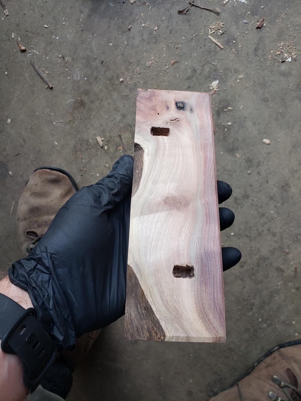

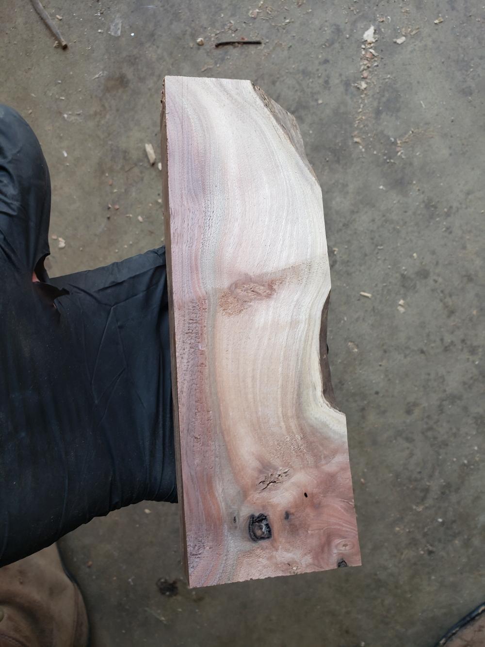

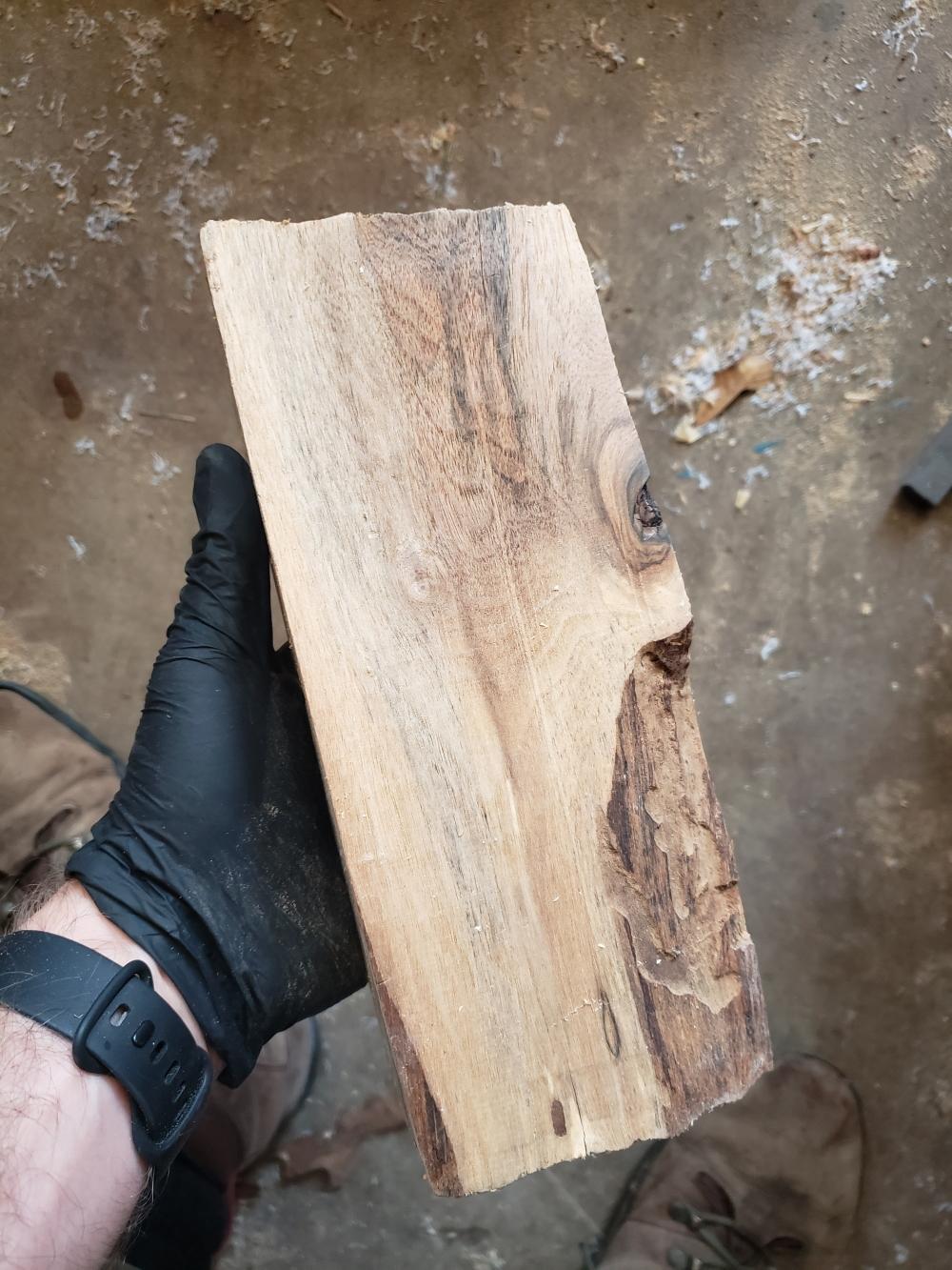

Since I was all out of Erumpent horn or Snarglewolfsnookleberry I opted for a piece of firewood that I deemed too beautiful to burn. I scavenged it from a pile years ago and it is a lovely curly grained piece of walnut that has air dried to perfection.

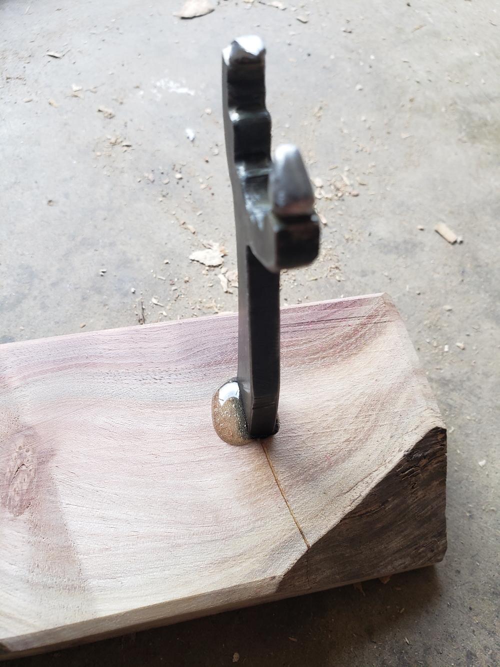

I slabbed off a piece but left some rough edges to make it look more “wizardy” I did not worry about it being perfectly cut or even quite level. I chiseled recesses for the claws to sit in and after some trial and error I got a setup I thought looked nice.
The lower claw held the wand nicely and it angled up the perfect amount should you need to quickly grab the wand to cast a protection spell.
The whole thing got sanded down to a 400 grit to bring out the grain pattern and colors

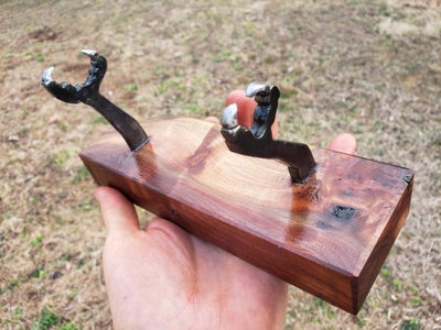

Personally, I like oil finishes on wood, especially this walnut so I covered it in butcher block wax/oil and let it dry then buffed it and did it 2 more times.
There is a slight layer of beeswax and the oil really brings out some of the color variation. The metal, being mild steel, also benefits from the oil and wax treatment.
All said, I am pretty pleased as this was my first go using hand files and it turned out better than I expected.
