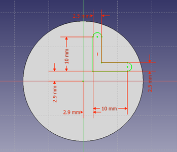

  • I used FreeCAD to draw a 35mm dia circle and "pad" it to make a 3mm thick disk.
  • I added an L shaped sketch to the disk with 10mm long legs and half round ends. This was placed half the thickness of the dividers (minus 0.1mm to make a snug fit) from the center in both x and y directions.
    • The dividers were 6mm thick so this distance is (6/2 - 0.1 =) 2.9mm.

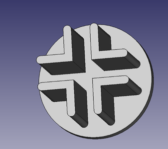

  • This L piece was padded 20mm and the "polar pattern" tool used to make the required four supports.
Step 3:
  • I added a 2.5mm thick 5mm square block to the L pieces 5mm from the disc to hold the braces in place.
  • The polar pattern tool was used to copy this block to all the supports.
  • This part was saved in FreeCAD for future use and also exported as an stl file.

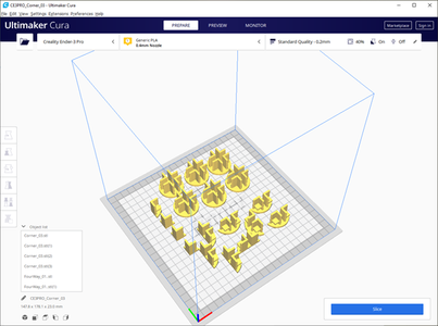

  • The stl file was imported into Cura and sliced with my standard PLA parameters.
  • The resulting gcode was saved then imported into OctoPrint.

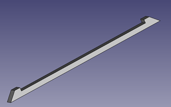

Step 5: Braces

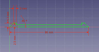

  • The braces were designed with 45 deg miters to vertical and horizontal bracing.
  • The length was calculated as the length of the compartments minus twice the thickness of the L piece walls.
Step 6: Printing
  • The box needs six four-way pieces, 10 edge pieces and four corner pieces.
  • All the stabilising parts were printed in a single print.
Note: ·
Printing the multi piece version was slightly tricky with my Creality Ender 3-pro. A web search for similar problems suggested reducing the Retraction Distance; the default of 6.5mm was reduced to 3mm and the problem was fixed.
