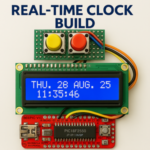

There are probably significant numbers of Clock already out there. I have some spare component to make the clock that had been sitting collecting dust, so here goes another clock that is not using Arduino but 18F2550. The idea is to build a clock that is accurate, and didn't lost the time when the power went out, so that when you plug it back in it remembers the last time and continue to display the right time.
Then you can expand the clock with additional features.
The latest version of the code should include the ability to display the Temperature from DS3231.

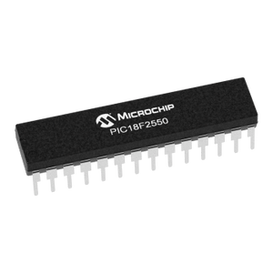

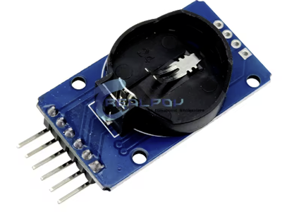

The microprocessors behind this is PIC 18F2550. This will be the brain of the compute module, it have the capability to display clock on it's own, but because we want a feature that will allow us to hold the time when the power is off, then we use the DS3231 RTC to keep track of time as this have a battery backup that will hold the time.
I am actually using the BEEPIC development board this will allow much faster uploading of the code.
The programming interface for this is using the MPLAB IDE to generate the .HEX file.

We are connecting the DS-3231
  1. SCL to PIN RB1 of PIC18F2550
  2. SDA to PIN RB0 of PIC18F2550

  1. RS to PIN RC6 of PIC18F2550
  2. E to PIN RC7 of PIC18F2550
  3. R/W connected to GND
  4. Vo connected to the Potentiometer (middle leg)
  5. VDD connected to + 5V
  6. VSS connected to GND
  7. LCD1 to PIN RA0 of PIC18F2550
  8. DB5 to PIN RA1 of PIC18F2550
  9. DB6 to PIN RA2 of PIC18F2550
  10. DB7 to PIN RA3 of PIC18F2550

Step 4: Build or Upload the Hex File
Open the MPLAB Ide and load the source file from the following Github repository
Once compiled, the will be a .HEX file in the folder and you can upload them using the MiEUSBHIDLoader in the same repository as above.
If you want a quick and easy way, there is a precompiled .HEX file already in the above repository named BeepicClock.hex
If all goes well you should have a working clock, and you can make adjustment to the brightness of the backlight using the 10K potentiometer.
The first button will cycle through the hour, minute, day, date, month and year
The second button will allow you to increment the numbers
Once you are happy with the way it looks, now it is time to build the real thing using the bread board.
The 18F2550 prototype board that I have can switch into the boot loader mode by pressing the button, and it will allow the HEX file to be uploaded as shown in the youtube video.
Step 5: Solder Each Component to the Breadboard
Start with the PIC, then design your way through and make sure each component is soldered and positioned well. Here are the orders of the component that soldered through.
Starting with the male headers for the PIC development board. Then the female header for the LCD display. Then slowing connecting all the LCD connection from female headers to the development board. Then positioning the switch on the opposite side, starting with the pull up resistors and then connecting the Realtime clock on the other side. The final component is the Potentiometer which connected to V0 (contrast adjustment).
Step 6: Finishing the Build
Repeat the same steps again to upload the boot loader if you haven't load it up and then make adjustment to the clock as necessary. Then adjust the contrast so that LCD is not too bright. Don't forget to attach a button cell. Now you have a fully working clock that you can brag about. And when the power reset, it will still remember the time until the next time it is plugged in.
