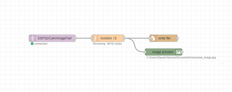

Step 5: Receive and Decode on Node-Red
Parts of FrameBuffer needs to be sent to same MQTT Topic.
Connect the incoming payload to a function. Once an entire image is sent, it will write it to a file with jpg format.
Function to receive, compile and decode to image -
  1. Initialization: Get value of Global Variable - imageData. Define it as Buffer in undefined.
  2. Edge Case: "START" signal received - empty buffer for new image reception.
  3. Edge Case: "End" signal received - compile Buffer to image, and send it to File Write Block.
  4. Otherwise, none of the edge cases are true - keep adding image pieces/chunks into the image buffer and return nothing.

I've connected it to a file write
Step 6: Look at My Baby Yoda and Arduino Sticker :)
Picture 1: Image Decoded at Node-Red canvas using Image Preview block (node-red-contrib-image-output)
Picture 2: A saved JPG file from ESP32-CAM, Decoded by Node-Red
