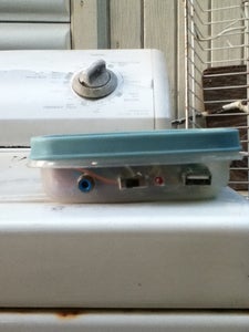

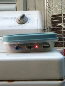

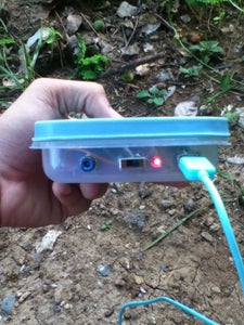

This is my first tutorial so go easy on me xD. Ok I made this charger because tired of being with out music (ipod) on school.because my school does not have power plugs.
Step 2: Partss!

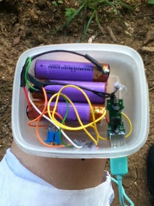

Ok we need: 3x ultrafire 3.7v batteries or 3x 4 volts batteries 1xcar cell phone charger 1x toggle switch Pair of cables 1x rca female plug (you will see its use later) Tools: Hot glue Scissors Black tape Pliers
Step 3: Building This

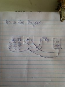

Now comes the good part.connect the 3 batteries in series if they are 3.7v they shoud give 11.1v out.now take apart the car charger.connect positive cable of batterie to center stem of the toggle switch.then connect the negative cable of the battery to the car charger and the rca female plug.connect the car charger positive cable to the right stem of the toggle switch and the positive cable of the rca female plug to the left stem of the toggle switch.

    Bros and sis don't make this it could be dangerous because most 18560 batteries are not protected. I made this in a time that I was 12 and didn't understand much about the dangers of li ions. Hope nobody got hurt. Go search for another tutorial, this is no good.

    I think something's will go wrong, as you are connecting cells in series so its voltage will increase current will be same i.e. capacity is 2200mA but rate of charge flow will be triple. I think you have to connect cells in parallel to improve capacity to 6600 mA and voltage will be acceptable to charge mobiles..

    its not in series bro look at first

    The capacity of an individual li-on of this type and size is more or less 2200mAh. In a series of three, the total comes out to around 6600mAh.
    0
    TonyC166
    TonyC166
    Reply 6 years ago
    Series ups the voltage, not capacity.
    Parallel ups the capacity, not voltage.
