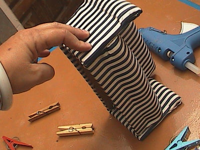

Step 7: Assembly 1
Make a sandwich folding the 2 small pieces in the middle. Adjust and fix with glue. Clip until the glue dry.
Put glue in the 7cm part (back seat) and then, join with the 12 cm part as show the photo
