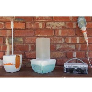

I made 3 different ones for some presents, you can get a few ideas from these but ultimately a lamp should be designed for your purpose!

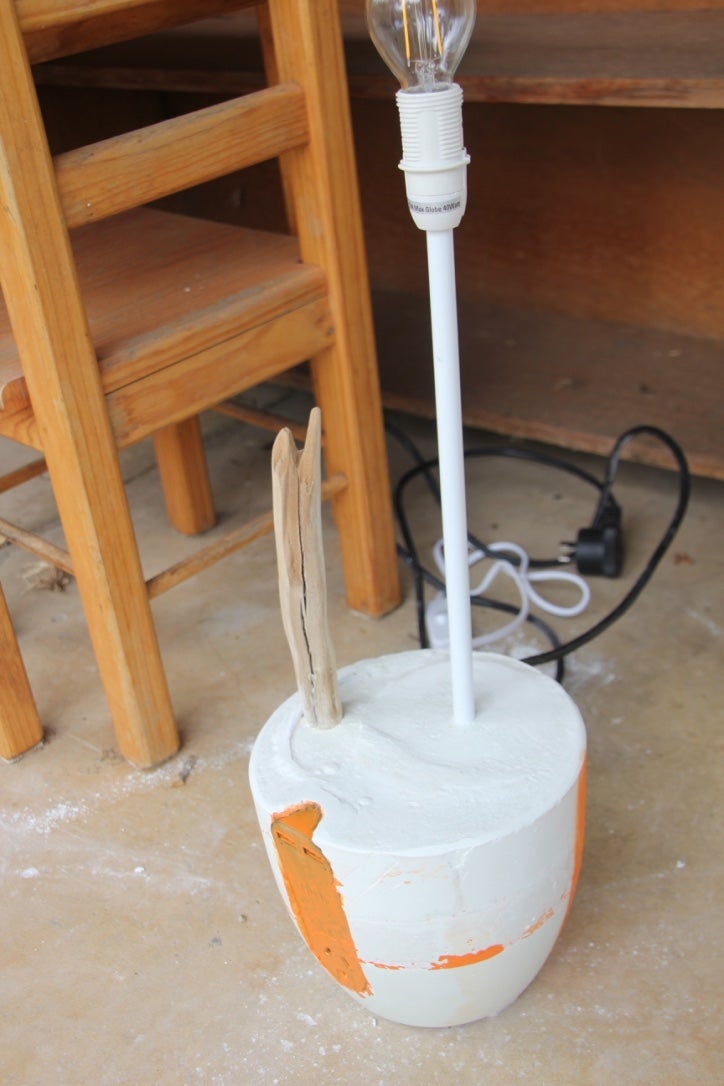

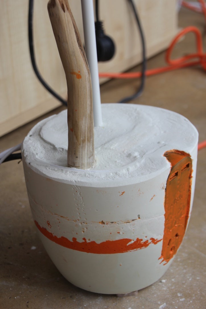

The orange lamp in the photo is for my partner, with a piece of drift wood she has had for several years set to hang some jewelry.

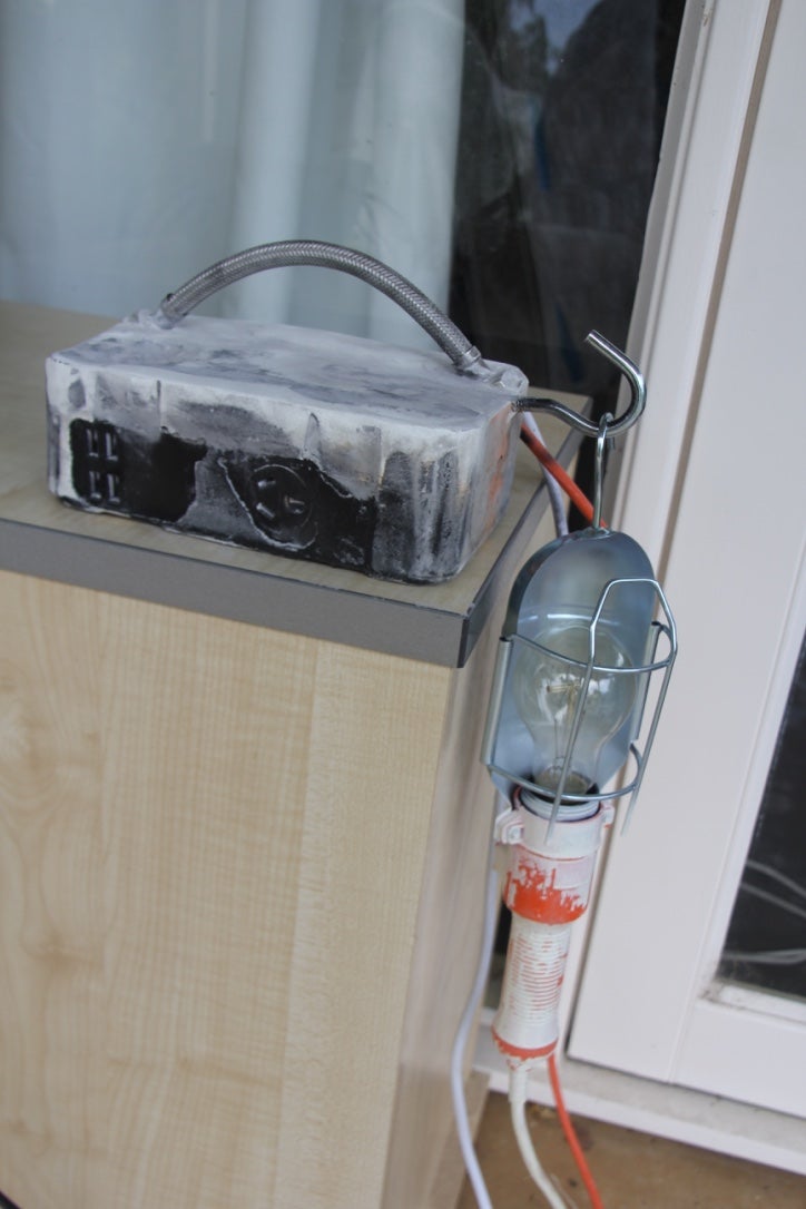

The black/grey one I made with a rack to hold my watches and a hook on the side for my keys.

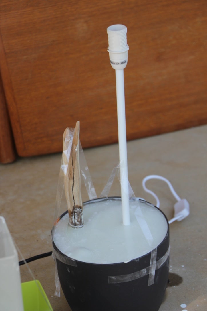

Step 3: Concreting the Electics Into the Pot Plant
place the USB hub flush against the wall of the pot.
Sticky tape in place.
Run the cords from the extension lead and lamp (if it has a switch along the line like these do) outside the pot by either running to the lip or cutting down the side with scissors and leaving trail out the pot halfway up.
Mic concrete in a bucket as per mixing instructions for the powder (usually 1:2 water:powder but just stir until thick).
pour until electrics are partially submerged.
Leave for 1h so the concrete holds in place.
SIDE NOTE

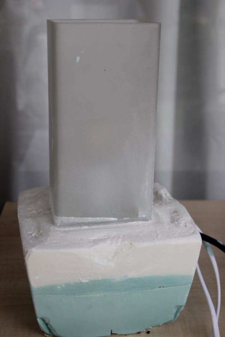

you can mix paint with the concrete in this stage to get a tinted color that makes a straight line halfway up the lamp when finished.
Step 4: Concrete Part 2: Setting Lamp and Other Paraphinalia
In this step I used polystyrene inside the pots to elevate and level the lamps. It can be a good recycle of this product and make the lamp overall lighter and act as a spacer inside.
Set the lamps on top of the submerged electrics that should now be partially immobile in the concrete bottom layer.
Cut down side of plastic and set things if you want things hanging out like a tap/hook.
If you cut down, make sure to seal with blutac. If you don't do this, when concrete is being poured it will leak and make a mess and harden.
Pour concrete to desired level. Again, you can add pain to the mix if you want to tint. I prefer to spray after so it looks a bit more industrial.
hold items in place with sticky tape scaffolding so they don't float/ go off balance.
Wait overnight.
