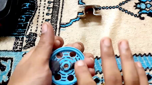

Now I needed to modify the clamp in such a way that I could easily attach the CCTV's stand.[ Just visit any electronic repair shops or cctv's shop, you can get it for free of cost.] Firstly I begin with cutting out a disc out of the PVC sheet. Then using PVC solvent glue the disc to the clamp. To provide easy access to the screw driver I also added certain holes in the disc as shown in the image 4. Using a cutter I carved out the threaded circular portion from the base of the camera case[Image 5]. And then glued it to the clamp using m-seal glue. Before gluing it make sure to provide spacing in correspondence to the disc we made earlier [used soldering iron for this purpose]. The provided spacings must be such that one can easily slide in the screwdriver as shown in the second last image. Our clamp attachment is over, now we can easily fix the stand to our clamp [as shown in last image].

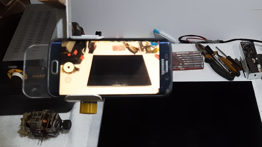

Since we already completed the holder assembly, now it's only lacking a base. For making the base I have used an ACP sheet. I have added fillet along the corners of the sheet. Then the holder assembly is fixed to the sheet using screws. Make sure to cut the projected part of the screw below the sheet. Now our awesome multi axis stand is complete. Now you can watch your online classes in any angle you want.
Step 8: Holder for Recording

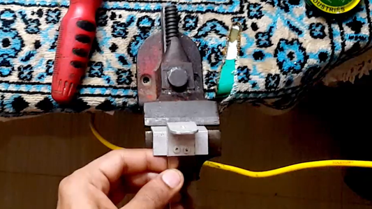

I badly needed a stand to help me in documenting my projects. Our holder assembly is attached to the C clamp via an aluminum L bar . And I also used a portable DVD hinge mechanism[ to increase the degrees of rotation] to fix the holder assembly to the L bar. Our super cheap yet amazing build is complete.
