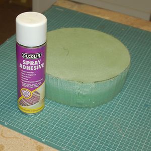

6. With the foam circles cut out you can then cut the fabric. You need 4 circles that are 40mm larger than the foam, and 2 strips for the sides that are about 40mm longer than the actual perimeter of each piece of foam.
7. I used Alcolin sprayable adhesive (sprayed onto the foam and fabric) to secure the top and bottom pieces of fabric onto the foam.
GOOD TO KNOW: Snip the edges of the excess fabric and fold these over the edge as shown.
GOOD TO KNOW: I left everything overnight, but for good measure added some masking tape around the sides to make sure that the fabric stuck down.
