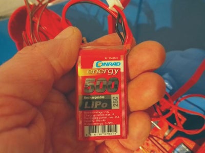

7.4V LiPo battery (500mAh) *

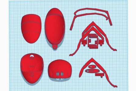

Step 1: Print the Parts
You need:
  • contruction plate (1x)
  • front/rear legs (4x)
  • big plates (4x)
  • small plates (4x)
  • servo brackets f+r (4x)
  • left mid leg (1x)
  • right mid leg (1x)
  • left mid bracket (1x)
  • right mid bracket (1x)
  • mid servo brackets (2x)
  • head sensor left (1x)
  • head sensor right (1x)

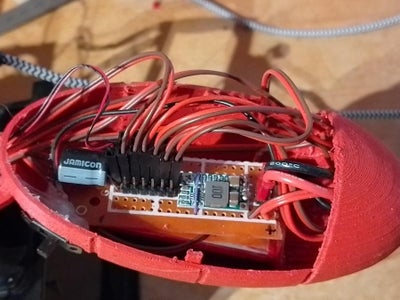

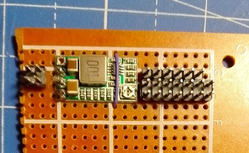

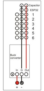

Step 6: Wiring and PCB

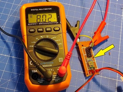

The 7.7V current is modified by an adjustable buck converter to 5V. Here we connect the servos and the ESP32 to the power supply. I used a little PCB with pins to connect (image). First separate the data cable (orange) of the servos. They should be connected to the ESP32 in the head later. Usually the wires of the servos are long enough. The current pins are connected to the selfmade pin board in the rear body part together with the battery.
It could be useful to insert a power switch. Install it at a suitable position (Step 7).

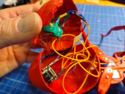

Step 8: Head and Antennas

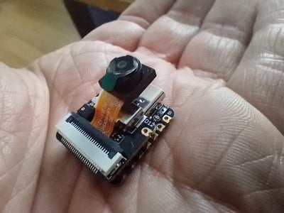

Mount the head with a screw. Now you have space for the ESP32-S3.
If you don't want sensors go ahead with the next step.

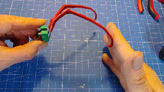

Solder some wires to the micro switches as seen in the picture, you can use the same GND wire for both switches. Insert the switches in the upper head part, fix them with hot glue.
After the head has been closed, you can connect the sensors to the switch levers.

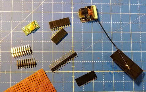

Step 9: Prepare the Microcontroller
The ESP32-S3 is surprisingly small and can be programmed with Arduino IDE. You can find help here:

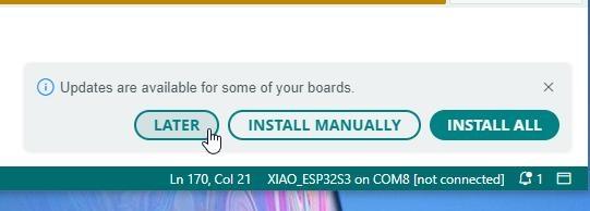

I struggled a long time to install the right servo library. I always got error messages.
The solution was:
1. Do not add only this to Arduino's board manager (File --> Preferences --> Additional board manager URL's)
https://raw.githubusercontent.com/espressif/arduino-esp32/gh-pages/package_esp32_index.json
but also this line:
https://raw.githubusercontent.com/espressif/arduino-esp32/gh-pages/package_esp32_dev_index.json
2. Board manager: ESP32, use Version 2.x. Version 3 is producing error messages with the servo libraries.
Resist when your Arduino ID prompts you to update the board information!
