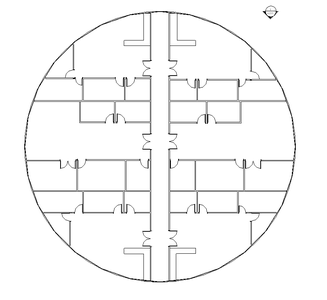

Step 25: Residential Units: Floor Plan
The largest portion of the building is its residential rooms. These can be found in the two pillars on either side of the building, where the right side is six stories of rooms, and the left side four. For the floor plan of the rooms, we went through a lot of design variations. Because the floor is circular, it was hard to create an efficient design. After 5 versions, we ended up settling on a design that had six rooms on each floor. Every floor is 100' in diameter, and has a fourteen-foot hallway separating it into two, which allows for anyone using mobility aids to have enough space to get through. On each side are three residential units, two normal and one penthouse.
The normal rooms are 43' by 34', and are placed in the corners of each floor. The entrance is in the middle section of the right wall and leads to an open space layout. To the far right, residents will find the bathroom, with a toilet and a shower. Attached to that is the bedroom, made for children, teens, and visitors. Next to that is the main bedroom, able to fit two. Below that is an extra room, which can be converted into a den, office, nursery, or whatever the residents need. Returning to the open space area of the unit, the kitchen is to the immediate left of the entrance, with the dining area behind it. The entire space is encompassed in natural light, as the entire third wall is a panoramic window. This room is best designed for smaller families, ranging from 2-4.
The penthouses are bigger, being in the center of the floor with two on each side. The room is 45' by 35', and comes with a few more rooms. The first room is the bathroom, directly next to the entrance. Across from the bathroom are two bedrooms, which are perfect for larger families. Next to the bathroom is the main bedroom, which has plenty of space for either parents or residents who need more space to accommodate their conditions. Sharing the same wall is the den, which is mainly used as a place of entertainment and relaxation, but is also fully customizable to the resident's desires. In the open space area, the kitchen is next to the dining room, where both are in the natural light provided by the panoramic window.

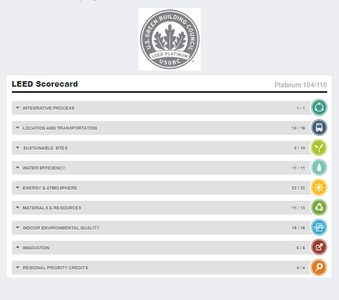

Step 33: LEED Certification
On top of our initial green future measures, our building is platinum LEED certified. The Leadership in Energy and Environmental Design service ensures that building designs are able to save energy, water, materials, and provide great indoor health. For our building, we went for an LEED for Building Design and Construction (BD+C), which is specified for apartment buildings, hospitals, and clinics. Getting a platinum certification requires at least an 80/110 score, which applies to 9 categories that our building works to have. The first is an integrative process, which encourages collaboration among team members from the beginning and analyzes water and energy systems early in the design. This accounts for 1 point. The next category is location and transportation, which requires the building to provide bike storage and EV charging, as well as be near public transit. Because our building is planned to be located near hospitals, which already have public transit available, this will be easy to integrate, giving us 15 points. Then, for 8 points, the site must be sustainable. This includes not disrupting natural habitats, using green roofs, and having rainwater management. The building is already made in local areas, so its construction does not contribute to environmental loss. Then, due to the rooftop garden, rainwater is easily used, and it works as a green roof. The low-flow fixtures in both the bathrooms and sinks meet the requirement for water efficiency, and the rooftop garden using rainwater means little to no irrigation is required, getting another 11 points. The most important requirement is energy and atmosphere, which is up to 33 points. This involves using renewable energy sources, such as solar on the roof. It also requires the use of HVAC systems, which our building has. Next is the materials and resources section, which requires that the building is made up of recycled, regional, reused, and FSC-certified materials, which amounts to 13 points. The materials must also be low-impact and durable, which all of ours are. Next, for 16 points, the building must have good indoor environmental quality, meaning the paint, adhesives, and flooring should be low-VOC, which every material we use is. Also, the category requires that there be plenty of natural light, which is present throughout the entire building. After this, the building needs to fit the regional priority credits. This means that it recognizes geographically important environmental concerns and addresses local priorities. We achieve this with community room and classroom events that discuss the impact of humanity on the environment and address the local water scarcity through the low-flow appliances, which earn 4 points. Finally, we get 6 points for the innovation category, as we referenced many different LEED-approved techniques in our design. Overall, because our design excels in these categories, it makes it the perfect fit for a clean, green future, getting a LEED platinum score of 104/110.

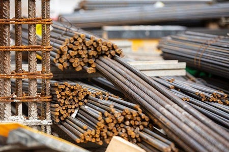

After construction can begin, the first step would be to clear the ground. Our building is flat by design, and therefore the site would need to be very close to level. Heavy machinery would then be used to dig space for the foundation to be poured, in addition to the excavation of the underground parking garage.
3 - Core Construction
As with any large industrial building, the structure must be constructed first. The recycled steel beams would be placed, outlining the two towers on either side of the building, and placed for the stairwells. The elevator shafts on each wing of the building would be framed, as well as the floors and roofs of the structure.
