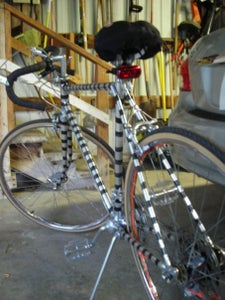

once its been stripped down to the frame take a medium grit sandpaper and go over then entire frame. you can do this with a power sander if you have one. the object is to not remove all the paint but to completely remove the rust and create an even surface for the primer. i chose a white primer since i used a light color scheme.
*BE SURE TO KEEP TRACK OF ALL THE SCREWS AND NUTS AS WELL AS HOW IT WAS PUT TOGETHER!*
soak the bike down and wash away and dust and dirt so you can get a good look at the rust. there are plenty of safe chemicals to remove rust and you can also use an s.o.s pad and rub it off as well. before you start to take it apart take pictures of all the pieces that are being removed so you can easily look at how it was put together for easy reassembly. after you got it all clean take apart the bike by removing the brakes, brake lines, gear lines, seat, wheels, back gear assembly and the chain. i simply took my pliers and cut the lines and ground the chain off since i was going to replace them anyway. your more then welcome to salvage them if they are in good condition.

after your bike is all pretty with a couple coats of primer find some fun paint and create a fun design.
this process it mainly up to how you see fit and your display of creativity. find a couple colors or just one and put some sweet detailing on it. put a couple coats of each on it . painters tape is your best friend when creating straight lines.
