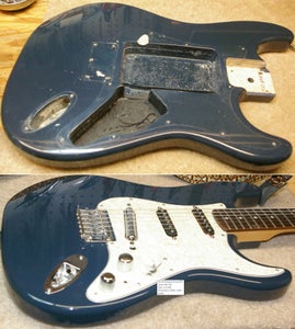

To get started I removed the pickguard to see what the guitar had in it. The original pots, jack and switch were about as cheap as I’ve ever seen – The plus side was that I noticed this was an Indonesian built guitar and seemed to have decent fit and finish on the wood parts.

I actually did most of this before I started on the wiring. One problem with Fender vs Squire is that the pickguards are slightly different and are not direct swaps between the two. In this case, I dry fitted the replacement pickguard, and then used a Dremel tool with a sanding head to carefully remove a little pickguard material from the neck and bridge areas. My lipstick pickup is a little wider and took up more space than the originals, so I used the Dremel to create a small depression in the guitar body to make room. After I had completed all of my wiring, I ended up having to chisel out another small area of the guitar body to clear space for some wires. And, of course, the screw holes didn't match up.

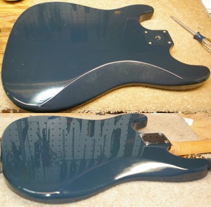

I don’t have step by step pictures of the polishing and waxing, but from the before and after pictures, I think it shows the value of doing this while you have a apart. It still has dents and dings from the kids, but it never looked this shiny before! The steps are pretty basic:
  1. Get the grime and dirt off - I use window cleaning solution on these polyurethane finishes.
  2. Polish with automotive polishing compound. This will remove and remaining dirt and polish out some of the extremely fine scuffs and scratches.
  3. Give it a good coat of automotive wax.
