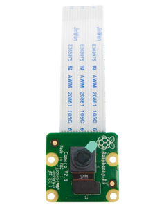

- 1 Raspberry Pi camera module
- Link: https://www.amazon.com/Raspberry-Zero-Camera-1080...

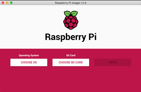

Step 1: Install OS Images
Materials: computer (Mac, Ubuntu 18.04, or Windows), microSD card, SD adapter
Basically, the Raspberry Pi runs the Raspbian OS, so we have to install the OS images on a microSD card. To do so, you need an SD adapter so a microSD card can be inserted into a regular laptop/computer's SD port (through which the images will be installed). Then, the microSD card is inserted into the Pi.
Follow the instructions here: https://www.raspberrypi.org/documentation/install...

Step 6: Camera Module
If you use a pi board with limited RAM, then it will only support the basic Pi Camera module. If you purchased a Pi 4 with more RAM (around 8 GB), you can try and implement the OpenCV camera. There are resources online to do so.
For now, though, you can work with the camera module, which will suffice.
