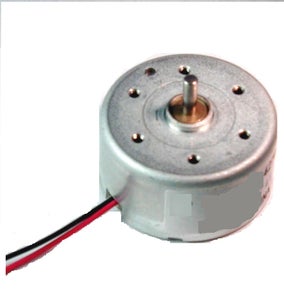

3. DC Motor.

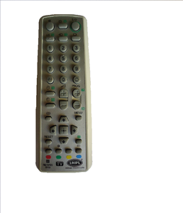

4. SIRC Remote Control

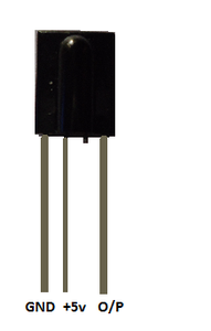

5. IR Receiver Module

Step 2: Remote Control
For Accepting the Commands from the Remote And giving it to Arduino. Please Refer to my Previous Instructable SIRC Remote Control.

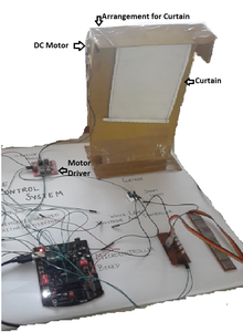

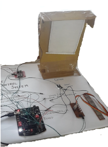

Step 3: Arrangement & Connections
Here I have to make special Arrangement of the Curtain for making the Model for display, but actually you just need to Connect the shaft of the Curtain directly with the DC motor for Rotation.
Connect the Terminals of the DC Motor to the Output pins of the Motor driver or to the output pins of the Relay Module.
Connect the Input pins of the Motor driver Module to the Digital pins 7 & 8 of Arduino Board.
