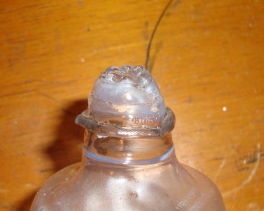

Step 1: Remove Label, Lid and Collar
First, TURN THE LIGHT SWITCH OFF. Now, if it's a lamp with a cord and plug then, UNPLUG THE LIGHT. Then, double check the light switch is off. Then double check that it's unplugged. If you've ever been shocked you'll know why I repeated those steps. LEARN from my mistakes here people! Haha The devise we're making is plastic so you're not likely to be shocked even if the power is on but it's better to be safe than sorry.
Now, take an empty water bottle. The heftier ones are better for this application. Remove the cap, the label and the little ring around the neck that breaks when you take the lid off.
Step 2: Melt the Bottle Neck
Step 3: Remove the Broken Light Bulb
GET OUT OF THE WAY
GET OUT OF THE WAY
GET OUT OF THE WAY ...
... when you push and twist so you don't get glass on you. If you've ever had glass lodged under your skin or in your eye you'll know why I repeated that four times. Again, learn from my mistakes here.
Congratulations, now you've removed the entire bulb without getting cut or electrocuted.
PS if you put a tiny bit of petroleum jelly on the threads of the new bulb it will be easier to take out when it burns out next time.
