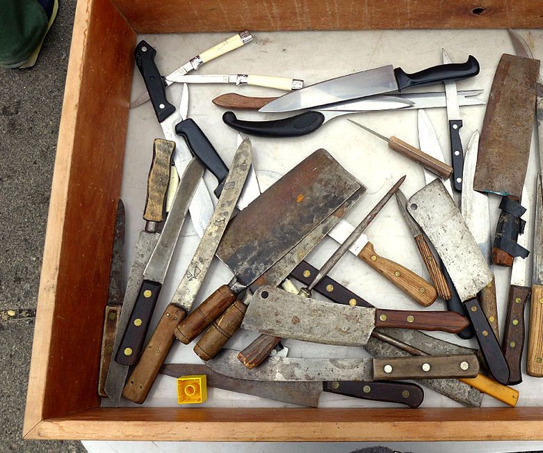

Introduction: Removing Rust With Citric Acid
This is one of the easiest, safest, and least abrasive ways to remove surface rust from old steel tools.
