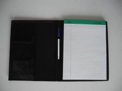

I have a much loved leather portfolio which I have been using for over 25 years. Sadly, the inside has ripped and frayed, and looked so tattered that it was embarrassing to use it. The duct tape contest inspired me to try repairing it with black duct tape. I am thrilled with the result (photo above) - the portfolio looks almost new - much better than buying a new one!

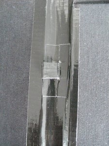

Step 4: Make New Pen Holder From Duct Tape
  • Cut a piece of tape about 1" wide from the roll
  • Fold about a 1/4" of the tape inward, along the long edge
  • Fold the other long edge inward, so that the raw edges meet roughly in the centre. This will be the inside of the pen holder loop
  • Cut a thin strip (about 1/2" wide) of duct tape and attach the pen holder strip to it (see 3rd photo)
  • Use this strip to attach one side of the pen holder to the middle of the portfolio. Fold pen holder in half with the remaining raw edge of pen holder extended away from the first thin strip
  • Cut another 1/2" strip and use it to cover the remaining raw edge of the pen holder strip and attach it to the portfolio. The two thin strips should meet (see 4th photo)
  • Unflatten the pen holder strip and insert pen!
Step 5: Touch Up Any Damaged Areas With a Black Sharpie and Enjoy Your New Portfolio!
Use a black Sharpie or other permanent ink felt pen to colour in any damaged or worn areas of the leather portfolio.
Carry your renewed portfolio with pride!
