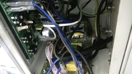

The problem is, that the motor and the speedsensor cable goes from the gearbox to th electrial control box through a big hole - so if I would fill it with grease, that would flow to the electronic too.
So I decided to isolate the two chambers with motor sealing silicone rubber.

The other two photos are only the cables (blue and white) from the motor, which I had to disconnect from the board.
