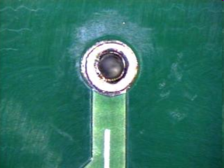

Step 1: Find the Right Drill Bit Size
Use progressively larger drill bits until you get to the right size where the plated hole can be drilled out. It should be slightly larger than than the opening of the plated through hole.

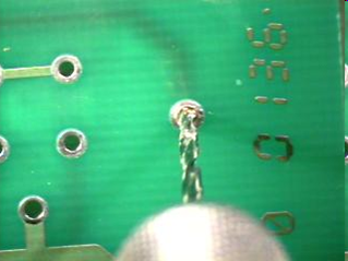

Step 2: Drill Out the Hole
Drill out the hole using a hand drill. Make sure you drill perpendicular to the plan of the PCB.

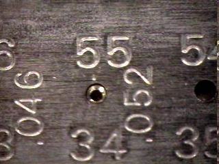

Step 3: Use Drill Template Gauge to Size Eyelet OD
Using a drill template gauge, size the correct eyelet size OD. A selection of eyelets that I use is here.

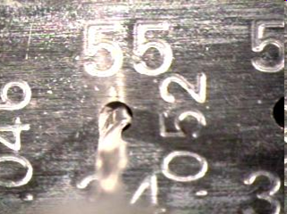

Step 4: Confirm That You Have the Right Eyelet Size
Using the drill guage make sure you have the correct eyelet size.
