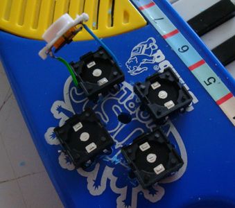

When working on my presenter project I replaced boring buttons with LED buttons of sparkfun.com.
http://www.sparkfun.com/products/10441
But there was no voltage indicated and I was not prudent enough. testing on 3V was ok, but 3.2 proved to be too much and the LED's were burnt.
Ordering again? Or trying to repair.

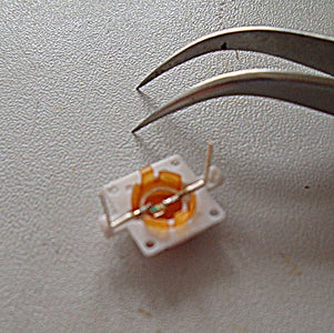

Carefully study the button
cut of the little black points, then the white top comes off, with the orange button.
undo the lower black part of the orange button, and the LED comes out, included the metal wire.
Admire the design of the small details in the buttons! While the rest of the world is just corruption, scandals and other terrible things, some people in China are carefully designing this beautiful small button! (A pity they forgot to include the max voltage for this LED button...)

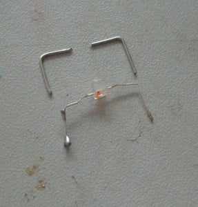

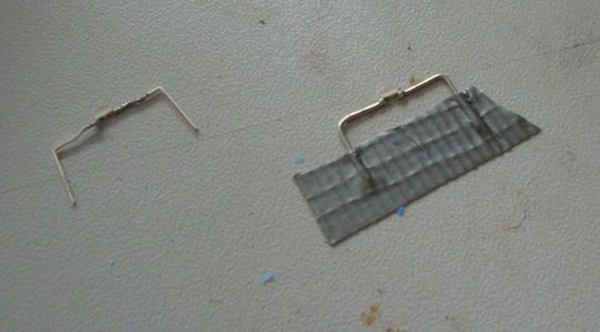

Now first I tried to solder SMD LED's on the same flat wire. This wire is flat to fit in and to be able to push. The trick I found out was to use duct tape to fasten the wires on the table. Then I could solder the SMD LED on the wires using the tweezer.
But this was a dead end, the elasticity of the flat wire was lost. The LED was on and working, but pushing was precarious.

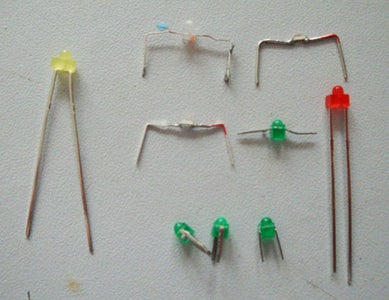

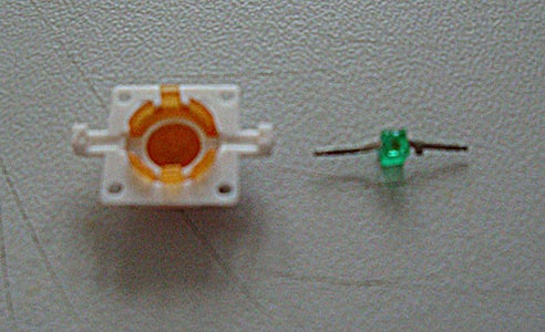

So back to the start. I had bought some scrap LED's at pollins.de. There were small green LED's inside and, really, these had flat metal legs…
These could be used inside the button. But they were green! Well this detail I had to accept.

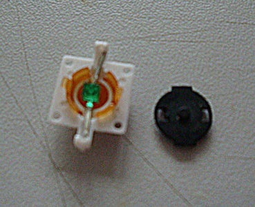

I could reassemble the LED inside the orange button, but of course the legs of the LED were too short. I had to solder thin wire to the legs to be able to restore the connections.
The funny thing is to see the orange button light up green!
I had to glue the corners of the buttons a bit, not too much, to restore the pushing possibility. These black points gave a bit of freedom for pushing, but these black dots I could not replace.
I added a resistor of 10K between the LED's and the batteries of 2xAAA.
