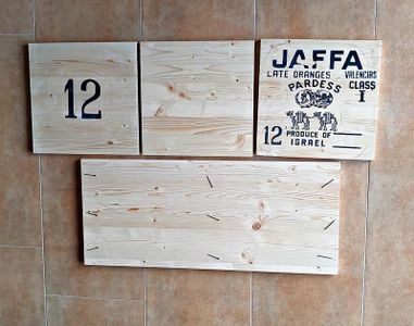

Step 1: Photo Transfer
The wood and the laser print are to be generously coated with the photo transfer medium. Then you put the paper on the wood and carefully squeeze out all the air bubbles.
Then wait 24 hours.
You can then rub off the paper with a damp sponge. The color is in the layer of dried medium and is not washed off.
I made this for the first time and next time I would not cut out the prints as shown on the photos. I would coat the entire wooden board with the medium and cover it with the printout, so that there is an even layer of medium over the whole board.
