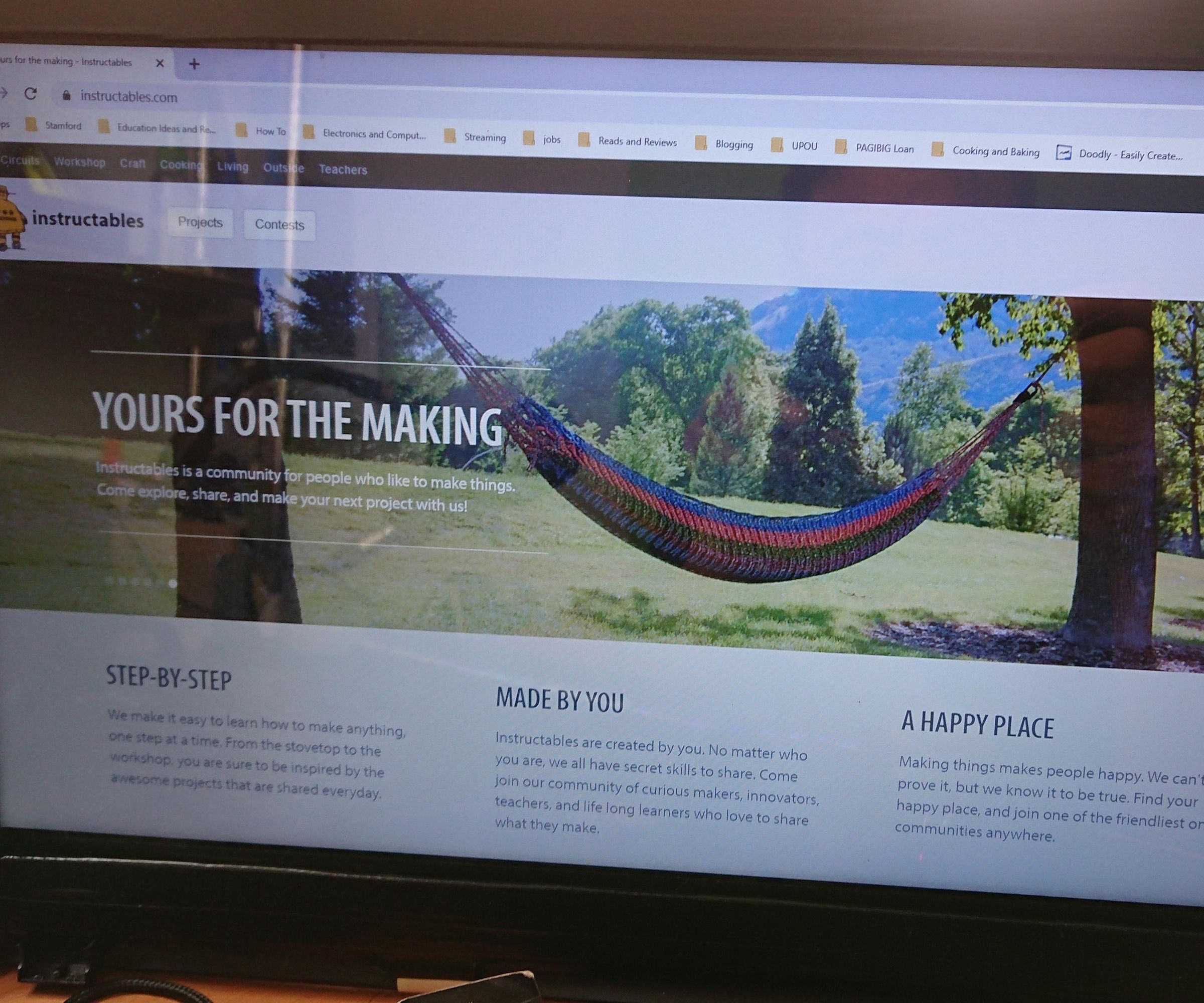

After a charge, I tested if the concept works by switching on the monitor through battery power, and it worked. However, during the real test of using the monitor, the monitor would not turn on. Upon inspection, I saw that one was no longer charging. So I replaced the dead battery with a spare one I had lying around. Also, I double-checked the connections to the protection circuit.
Unfortunately, after a second full test, some of the batteries were still fully discharged, leading me to believe that the LVDS board was the issue. So I removed its barrel jack, mounted it straight to the protection circuit, and connected it to the LVDS board via cables to where it used to be connected. This worked wonders, as the batteries now charge properly and the LVDS board gets its power from either the batteries or the power supply.
I then made a cable with 4 wires and a 4-pin PHR connector, which matches the one on the LVDS board. This was then used to connect the positive terminal of the protection board onto the 12V terminal of the LVDS board, and similarly with the ground terminals. This allows the board to be powered by the battery, as well as charge it with a 12V power supply while powering the screen. Upon testing, this worked without a hitch.
UPDATE 19 April 2021
It's been a while since I visited this Instructable, and I realized I have not given any of the promised updates. So here we go...
Upon the suggestion on the comments (thanks to Copper Dog), I decided to see if adding more cells in parallel would do the trick. This would make the battery's overall internal resistance smaller, which should mean a larger maximum current can be delivered for the same voltage, thus stabilizing the power output, and thus preventing the laptop flicker. End result: it works! The screen no longer switches on and off, when it needs to be charged; it just turns off. Also, this makes the screen have a longer running time. The downside is, it's now a bit heavier.
Step 6: Testing
Since the batteries were charged before installation, I expected the screen to turn on once the soldering was complete. However, this was not the case, so I powered up the screen with the 12V power supply for a few minutes, during which the screen lit up immediately.
While waiting for the batteries to be charged a little, I connected my laptop to the screen with an HDMI cable, and it worked perfectly.
After waiting 5 minutes, I removed the charger to see if the batteries worked, and they did! I then turned off the screen, and saw that it was still being powered since the built-in on-off light is still on. I now am finding the time that the screen would stay in its standby mode before actually turning off.
I then decided to test how long the batteries will last on a full charge. Since the batteries are not new, I did not expect a long battery life. However, I was pleasantly surprised that the batteries can power the screen for about 45 minutes.
On an interesting note, I also measured the voltage across the batteries as they were discharging. I noticed that when the screen's back-light was turned on, the voltage reading went down to about 0.7 V below the reading when the back light is off. Furthermore, the protection board would turn off the power to the screen at 9.7 V across the batteries. Afterwards, the voltage shoots up to 10.4 V, turning the screen on again. This is an issue to be dealt with later, but suffice to say that for now, the batteries must be charged when the screen turns off.
All in all, this is a successful project, and should be easily replicated.
