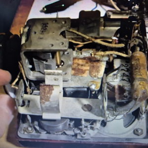

Step 1: Examining Radio for Missing Parts.
The first step is to examine the radio for missing parts. It turned out that the audio transformer had been taken out and filament battery holder was rusty. The radio also had three missing tubes out of four. Luckily, I had a junk radio of the same type on hand that I could supply the audio transformer, battery holder and three tubes.

Step 3: Most of the Wires Are Rotten.
Almost all of the wires in the radio have cracked and rotten insulation, so I will need to replace them with all of the capacitors.
Step 4: Soldering New Wires
As I opened up various parts of the radio, I replaced wires with ones of the same or similar colors.

Step 7: Installed Tubes, Replaced Old Capacitors and Replaced Wiring.
After Installing tubes, replacing old capacitors, old wiring and added the new A battery holder, I attached the radio to power and put an oscilloscope on the IF oscillator/converter tube. I should've seen a sign wave but saw nothing but noise.
Step 8: I Did Some Continuity Checking With a VTVM.
I started doing continuity checks with a VTVM and found that the oscillator coil had a broken connection. I was getting a loud hum when I put my fingers on the first tube and also on the last tube. When I touched a screwdriver to the control grid of the last tube, I got a loud hum. This showed that the tubes were amplifying and passing signals through the chain. I figured that I should replace the oscillator coil with the one from the junk radio.
Step 9: Replaced the Oscillator Coil With the One From the Junk Radio.
I swapped the oscillator coil from the donor radio to this radio. I reapplied power to the radio and attached the scope to the converter tube, I saw the sign wave that is supposed to be there and as I moved the tuner the frequency changed. I removed it and heard music from the radio. I did an alignment on the IF transformers because the oscillator coil had slightly different characteristics than the one that was in previously. I checked out the performance and it was excellent. I made up a battery pack of 6 nine volt batteries adding up to 54 volts in series and installed the standard 1.5 volt flashlight battery for the filaments.
