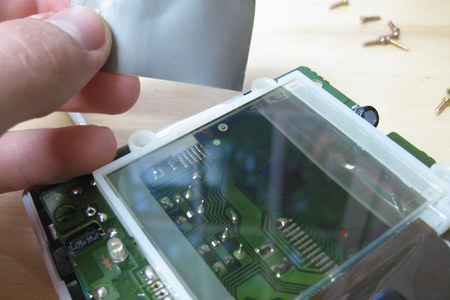

First, remove the two screws on the brown connector just below the display. This will free up the display, and allow you to take it out of the white plastic frame. After gently prying the display out of its frame, use a sharp pair of snips to cut off around a centimeter of the thin plastic frame below the display. This will give us room to pass wires beneath the connector.
Next is the only tricky part of the process. Using a sharp knife or razor blade, you have to remove both the reflective back layer and polarizing film from the LCD. If the display still looks a green color after you’ve done this, you have only removed the reflective film and not the polarizing layer. Try again to catch the edge of the film, and slowly peel it off until you are left with a transparent LCD.
In the third photo I’ve only begun removing the reflective film. You can tell because the display still looks green behind it. Go back and make sure you’ve removed that green tinted layer.
After doing this, remove the protective cover from the backlight module and slide it underneath the display in the plastic frame. Route the wires through the slot you cut earlier.
