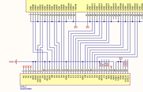

As different DPI/RGB interface LCD module may be used in this console, here we take the module used in my own build as example. And if you chose a different one, check the pin definition of your module and just make the connections according to the pin names as showed in the example.
There are two interfaces on the LCD module: an SPI and a DPI. The SPI is used to configure the initial settings of the LCD driver IC and we can connect them to any unused GPIO. Only connect the Reset, CS, MOSI(SDA/SDI) and SCLK(SCL) pins, the MISO(SDO) pin is not used. To initialize the LCD driver, here we use the BCM2835 C Library to drive the GPIOs and outputs a certain initialize sequence provided by the module supplier. The source file can be found later in this instructable.
Install the BCM2835 C Library on another Raspberry Pi 3 according to the instructions here. Then use the command "gcc -o lcd_init lcd_init.c -lbcm2835" to compile the source file. Then add a new line in the /etc/rc.local file before "exit 0": "/home/pi/lcd_init"(assume you have put the compiled application under /home/pi folder). It should be emphasis that the source file is only used for the certain module I used and for a different LCD module, just ask the supplier for a initialize sequence and modify the source file accordingly. This process is quite tricky because at this point nothing can be seen from the screen, that's why I strongly suggest you do this on a RPI-CMIO board as it leads out all the GPIOs so you can debug it with uart or wlan.
The following part is easy, just connect the left pins of the LCD module according to here. Depends on what kind of LCD module you have got, chose the RGB mode wisely. For me, here I chose the DPI_OUTPUT_FORMAT_18BIT_666_CFG2(mode 6). Alter the "dpi_output_format=0x078206" line according to your choice. And if your LCD module uses a different resolution, adjust the "hdmi_timings=480 0 41 60 20 800 0 5 10 10 0 0 0 60 0 32000000" refer to the file here.
If all the settings are correct, on the next boot up of your Pi, you should see the display on the screen after a 30-40s black(from power to system loads your SPI initialization script).

1) Triple check the pin connection of LCD module on the schematic and PCB.
2) Route the LCD signal wires with length constraint.
3) When you are not sure about the power sections, solder and test each section follow the power sequence. 5V first and then 3.3V, and 1.8V. After all the power sections are tested, solder the other components.
4) If the display blurs frequently, try invert the polarity of the PCLK signal by setting the dpi_output_format.
5) If the display is off center a lot, try invert the polarity of the HSYNC or VSYNC signal.
6) If the display is off center slightly, try adjust the overscan settings.
7) If the display is black, try to wait for the system to boot up to the rc.local script. If you need display from the start, try to wire the SPI interface to the MCU and use the MCU to initialize the LCD module.
8) If the display is black all the time, check the initialization sequence again.
