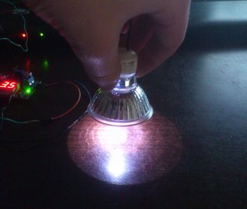

Tiny LEDs emit a lot of light, but the light is poorly directed. Making your own reflector doesn't give a neat result in most cases, so why not reuse a reflector?
I found out that GU10 halogen spots are easy to disassemble, and easy to reuse. This particular lamp was a cheap one I got included with a fixture and it broke after only a few hundred hours. Note that depending on how your own specimen was assembled, the disassembly might be harder.

There is room for at least 2 LEDs in the back of the reflector. Make sure they stick in the reflector a bit to insure good light spread. The holes of the removed pins serve nicely as wire leads.
Step 3: Before/after Pictures
This is using one white LED from a discarded flashlight. It makes a huge difference as you can see.
