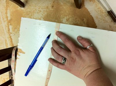

We bought several poplar boards instead of a solid piece of wood. It was cheaper and fit in our car. This was years ago, and the glued tabletop has been sitting around for quite some time before I finally started this project on my own.
We didn't have anything large to clamp the boards together and hold them flat as they glued, so we used a different technique. Josh had seen joining jigs using rope and wedges in some luthiers forum he was poking around, and the technique worked fine for this.
Josh put wood glue on the edges of the boards and pressed them together, laying them over some 2x2 pieces of wood wrapped in waxed paper. The waxed paper kept the tabletop from being glued to the wood it was resting on as it was pressed together and a little wood glue was squashed out.
He then placed waxed paper wrapped wedges on top of the table, directly over the bottom pieces of wood. He wrapped some nylon cord tightly over the table and around the ends of the bottom pieces of wood in a figure eight pattern with the overlapping cords on top of the wedges as shown. We tapped at the short, flat ends of the wedges (not the pointy ends) with a hammer to shove them in more tightly. Some people use flat pieces of wood right under the wedges, but we didn't feel like it.
The wedges, held tightly by the rope, applied even downward pressure while the wood glue set up overnight.

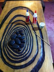

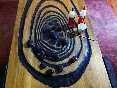

Draw the rough shape of the rings you'll carve. Lay out the stones where you want them and trace around them. Make sure you can put the stones back in the right spots later on.
I didn't have many tools; there's probably something out there that makes carving a coffee table a bit easier. I used a gouge and a dremel.
I began by carving the rings, tapping the gouge through the wood with Josh's fret hammer (it happened to be the first hammer I grabbed). This took a fair amount of time. I was careful not to try to dig the gouge too deep at once and split the wood.
After some time, I alternated using the dremel to carve the rings wider and deeper. I wanted the table to look a bit rough, so I didn't worry too much about little mistakes when the dremel spun out of the groove I was carving. Using the dremel created a lot of dust and I vacuumed it often.
I didn't have any power tool to sand the table, so I sanded it by hand, working my way through the grits from 60 to 220. I left some larger scratches in with the lower grits, smoothing the edges of the deep scratches with the much higher grits. I did this because I wanted it to look older and worn, but I didn't want it to feel rough or scratchy.

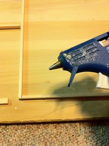

I bought a cheap picture frame from Ikea and decided the plastic would be great to use for a magnet activity table. I used the cardboard from the picture frame to lay out the wood frame for the activity table.
I bought eight pieces of 3/8" x 1/4" x 36" basswood at the craft store. I didn't want the plastic to be too far from the items in the table because the items were heavier than the iron filings in Noah's Wooly Willy table, so I didn't opt for 1/2" wide strips.
Lay out four pieces of the basswood on the cardboard to form five sections as shown in the picture, making sure the side measuring 3/8" is vertical. Tape the strips down so they don't move and mark them at the edges of the cardboard where they need to be cut. Untape the pieces and cut appropriately, then lay them back in place on the cardboard. Take the remaining four strips of wood, lay them around the perimeter, and mark where to cut them.
The long sides on this table were longer than the strips, so I used leftover cut pieces of wood on the perimeter of the frame that bordered a short section on a long side. I used a glue gun to join the pieces of wood together because it was easier than figuring out how to clamp them while wood glue or gorilla glue set. Superglue was too brittle.

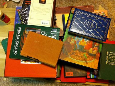

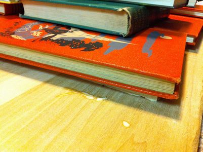

Once the frame is assembled, glue it to the tabletop. Clean off the side of the tabletop opposite of the ripples and stones side, especially if pink medicine spilled on it, dripped down, and dried there months ago. Lay out the frame to determine where on the table you want it. Apply wood glue evenly to the bottom of the frame, spreading it with a cotton swab. Because this table will be turned over and will contain small particles of sand and iron filings, it's important to be thorough with the glue. It would not be good to have the sand or iron filings spill out of their compartments. Turn the frame over so the glued bottom is now on the wood table top. Place some books on the frame to press it into the table top. You can take off the books and clean up any excess glue if you remember. I forgot until two hours later... I started to wipe up excess but decided it was too much of a hassle because the drips had stiffened. Let the frame set up overnight before messing with it.

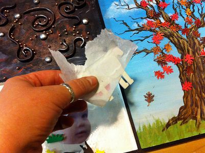

My kids aren't bald. Josh helped me use Photoshop to make them look bald, though. I printed out pictures of their faces and cut them out.
Paint the section of your table white. It might take several coats, especially if you didn't finish the wood on that side yet. When the paint is dry, use a glue stick to glue the faces to the wood.
I added white glue to the tops of their faces, but this was probably unnecessary because I covered them with some clear film. I didn't have acetate and couldn't find the right size sheet in town, so I used the sticky part of a couple self laminating sheets.
Whatever you use, trim it to fit and stick it in place. You'll probably have to add silicone glue to the edges if you use acetate. It would be bad to get iron filings under the acetate.
It would be simplest to buy iron filings, but I forgot to order some and didn't find any in town (I don't have time to drive around looking for things). Fortunately, the soil in our yard seems to have high amounts of iron. I already had a bunch of fine sifted dirt Josh was using to make a dorodango. I put two bar magnets in a plastic bag and sprinkled dirt over it until a fair amount stuck to the magnet. I then put the plastic bag, magnet, and iron rich soil into a small plastic container with a lid. I held the plastic bag inside the container while pulling the magnet out of the bag. The iron rich soil dropped from the bag into the container. I pulled the bag out and repeated the process a couple times. I knew there was still a fair bit of dirt mixed in with the iron I collected, so I used the magnet to sift it. I pressed the magnet against the side of the container, put on the lid, and shook it. The particles with iron clung to the side of the container against the magnet while the bits without much iron fell to the bottom. I kept the magnet pressed tightly against the side of the container while carefully removing the lid and then pouring out the dirt that wasn't stuck to the magnet. I repeated the sifting a few times to make sure the iron was as pure as I could get.

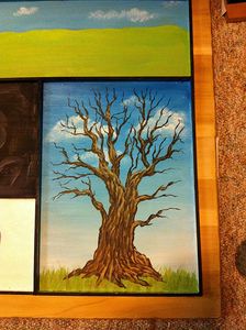

I painted a blue background, making it darker blue at the top and lighter blue at the bottom; often the sky is lighter at the horizon.
Dab on some clouds.
Paint the ground green. Add some brush strokes of various shades of greenish brown for grass.
Paint an outline of a tree, fill in the branches and trunk, and mix up a darker shade of brown. Paint in wiggly lines with the dark brown for texture in the bark. Mix a lighter shade of brown and paint highlights on the bark. You can decide where a light source would be and paint the highlights where the light would hit the tree most directly, and darken shadows where the tree would be darkest. If you're not up for that, you can put highlights and shadows wherever the hell you feel like putting them and tell people the tree is stylized, not realistic.

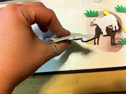

I was tired and didn't want to cut out animal shapes, so I bought some animal stickers. They were sticky on the back, so I stuck them to some tissue paper I had and tore away the excess. I inserted little nails into the animals, making sure they weren't too visible from the top. The baby chicks were too small for the nails, so I bent some staples and glued them to the back of the chicks instead using a glue gun. Two staples was enough metal for the magnet to pull the chicks around under the plastic.

Glue the sections down using a glue gun.

Make sure the wooden frame is painted as you want it. Add the items to the frame if you haven't already. Put the leaves face up if they're not double sided. Add the sand and tools. Add the metal balls and plastic beads. Add the barnyard animals. Add the iron filings.
If the clear plastic has a protective film on both sides, unpeel it from one side. Carefully, thoroughly apply the glue to the edges of the wood frame. Be especially sure to create a complete barrier on the sections that contain the sand and iron filings.
Line up the short side of the clear plastic with the short side of the frame. Keeping those edges aligned, lay the plastic down on the glued edges of the frame. You want to be precise with this. You'll smear glue and it'll look REALLY bad if you have to slide the plastic after it's touched the glue.
Press the plastic down and examine all the wood edges to make sure the glue forms a seal around each section. Place books over the plastic to hold everything in place. Leave overnight.
Pull off the books and check out your handiwork.

I chose a simple design so I'd only have to worry about two legs. We removed a folding door from our dining room awhile ago, and I figured it would make decent legs for this table. I wanted to make sure we could simply set the tabletop on the legs and not worry about it sliding around.

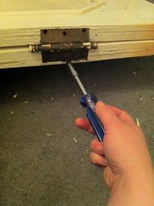

I removed the hinges and propped a section of the door on two chairs so I could make some cuts with the circular saw Josh inherited from his grandpa. I'll try to explain the measurements of the pieces I cut in relation to the table.
two of Piece A - the outside end of each leg - as wide as the end of the table top plus two thicknesses of the door, as high as the width of a panel of the door (I used the width of the pieces of door as the height of the table to simplify things)
two of Piece B - the inside end of each leg - as wide as the end of the table, as high as the with of a panel of door minus the thickness of the tabletop
four of Piece C - the outside sides of each leg - as high as the width of the door, as wide as one quarter the length of the remaining panel of door from which I already cut the two of Piece B
four of Piece D - the inside sides of each leg - as high as the width of the door minus the thickness of the tabletop, as wide as one quarter the length of the remaining panel of door from which I already cut two of Piece A
The four D pieces are less wide than the four C pieces, which makes them fit well inside of them. The inch wide strips I cut from the B and D pieces were the only wasted wood from the door.
I pried up the decorative molding and pulled out the little nails. I sanded down all edges and some of the paint in order to glue the pieces together. I applied wood glue to a flat side of a Piece B, spread it thoroughly, and pressed it down against a flat side of Piece A, making sure the bottoms were aligned, the sides of Piece B were centered between the sides of the wider Piece A, and the top edge of Piece B was a tabletop's thickness below the top edge of Piece A. I stacked some heavy books on Piece B because it was easier than trying to clamp it and let sit for a few hours.
I took a Piece C and applied wood glue to one of the long edges, spreading it thoroughly. I pressed the glued side down onto Piece A, right where it bordered Piece B on one side. I carefully balanced some books on it while I spread glue on a flat side and a long edge of a Piece D. I pressed the glued flat side of Piece D against the inside flat side of Piece C, while the glued long edge was pressed down into Piece B. I made sure the top and bottom edge of Piece D lined up with the top and bottom edge of Piece B. In this picture, Piece C has some cracks in the plywood, so I added some wood glue before clamping Piece C and Piece D together. I angled the clamps so I could rest a bunch of books on top, pressing Pieces C and D into Pieces A and B.
I repeated this on the other side of the first leg, then did the whole thing again for the second leg.
After the glue had been allowed to sit for hours, I removed the books and clamps. I had some leftover plaster from a bathroom project and applied it thinly to seal the spaces in the cut ends of plywood and some imperfect seams in the legs. After I let the plaster dry overnight, I sanded it and painted both legs with black acrylic paint. It needed a couple coats in some areas.

After the acrylic paint is dry, set the two legs upright, making sure the indentation for the table top is in the top of each leg. Set the tabletop in the legs so that it rests on the inside edge of the legs and is bordered by the outside edge of the legs.
Find your river stones and make sure you know which holes they fit in before mixing the epoxy. Mix about a tablespoon of epoxy in a paper cup with a wooden skewer. Remove one stone at a time, add a small amount of epoxy to the indentation in the table, then push the stone into place. Let epoxy set up for 24 hours before letting your kids pound on the rocks with toys (if your kids do that sort of thing... mine sure do).
If you're up for letting them play with the magnet activity side, just lift the tabletop off the legs, flip it over, and set it back down.
