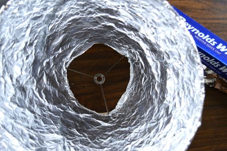

Step 2: Wrap It
1. Keeping the most reflective side of the aluminum foil face up, add the foil to the inside of the lampshade (covering it completely).
2. Fold the top of the foil over the lip of the lampshade, making little tears in the foil to help it lie flat along the curve of the brim.
Note: You can add tape to secure the seams if you deem it necessary.
