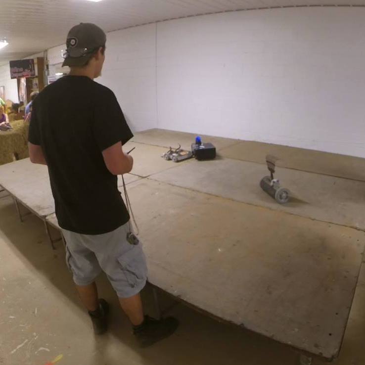

Test video of the weapon vs 1/4" thick steel. (please excuse the one handed driving)
