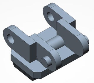

To begin, I drew a handful of rough pencil sketches just to give myself a an idea of how the treads could work and eventually moved the idea over into 123D beta 9. A copy of the model was printed, and the pieces of track snapped together just as intended.

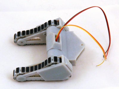

The treads where printed using one of the Objets more interesting features, the ability to print combinations of separate types of materials at the same time. The light blue areas of track are mostly a rigid white material with a pinch of rubbery black. This gives the print a solid structure with just enough flex to be snapped together. The rubber treads are more rubber than rigid, making an outer surface that gets much better traction than its light blue counterpart. Since the two materials are printed together they are permanently bonded.
When it came time to make this hub for the track I tried to build around my initial tread design, but the geometry just wouldn't work out. I ended up starting from scratch by drawing a hub first and a track made to fit around it. The new parts were printed out, assembled and tested. Happily, the mechanics flowed like they were made for each other! I tweaked the tolerances by .05 mm or so and printed a few dozen links.
The base is held together with short 0-80 thread machine screws that go through one side of the enclosure and attach to holes on the opposing side. Although these holes are included in the model, and the printer did render them, I still found it necessary to use small drill bits to adjust tolerances and remove support material.
Motors are secured in place with mounts built into the two halves of the base. To get the motors to fit perfectly I ended up making a model of the gear motors from dimensions taken with a digital caliper. The motor mounts were then designed around that virtual motor.
