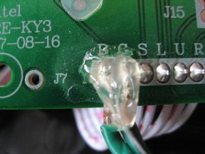

Step 4: Heat Up the Gun
You're going to need to solder wires to these two points, the ground and the back/select button.
Step 5: Solder Hero
Hopefully it'll look something like this.
Step 6: Fun With Glue
Give a dab of hot glue to cover up any exposed wire. Once it's dry you can reattach the circuit board to the guitar.
