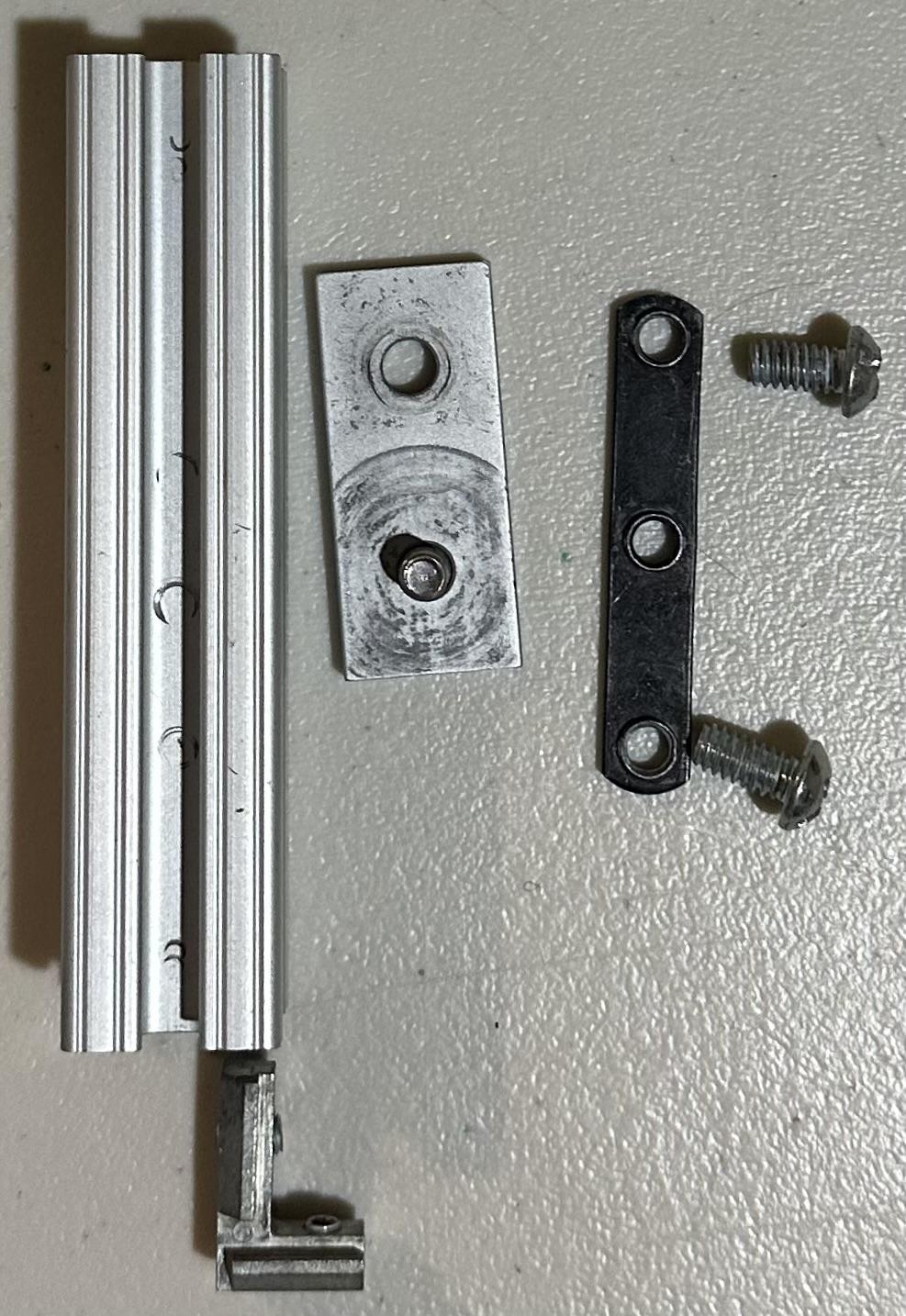

Step 2: Construct Launch Rail
Use the parts shown to attach the brackets onto the extruded aluminum. The flat, black screws should be lower than the thicker-headed silver ones. Then, place the invisible connector on the base of the aluminum with the brackets, and attach the shorter aluminum T channel to the invisible connector so it is flush with the brackets. **In the last picture, only the invisible connector and short aluminum T channel are needed during this step.

Step 4: Screw Launch Rail Onto Board
Screw the launch rail onto the plywood using 1"x1/4-20 machine screws inside of the threaded inserts. Then, insert a T nut into the short aluminum and screw in another machine screw through the back of the board in the previously drilled hole.
Step 5: Assemble Water Bottle Rocket Launcher Holder
Screw the countersunk screw into the flat aluminum piece and the bottle launcher. Then, screw a screw through the other hole on that same bracket and into the black insert which is inside the aluminum extrusion. Finally, screw in the last screw to lock the bracket in place.
