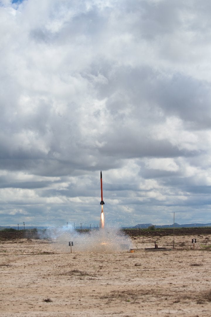

For our tests we elected to use 54mm single grain rocket motors. This is relatively small for High Power rocketry, but it keeps the costs associated with characterizing a propellant down. Our testing shows that single grain tests work as well if not better than multiple grain tests.
But I'm getting ahead of myself. Let's take a look at a test burn. Then I will provide some pointers to those interested in getting involved for the first time in the High Power Rocketry hobby including eventually testing your own propellants...
Step 1: Rocket Motor Test Burns...
The video shown here was one of 6 burns of a new propellant. The goal was to test an old propellant with a new Burn Rate Catalyst. The base propellant (called Vee-Oh-Lay and identified as VOL) was created by Raymond Kinsel many years ago. It is used by many "research" rocketeers throughout the hobby. It is favored for being relatively low pressure but high performance. Ray, myself, and others have run VOL from small motors (54mm and smaller) up to very large motors. Personally I've flown rockets with "M" motors using VOL, but others have gone as high a "P" motors. By changing the burn rate catalyst Ray was able to increase the performance of VOL. But please don't ask for the formula! That is Ray's and while he is very good about sharing his formulas, if you are new to High Power Rocketry there are things you need to do first!

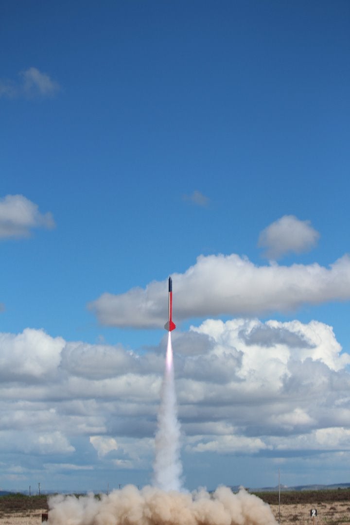

Step 2: Getting Involved in High Power Rocketry
If you are interested in getting involved in High Power Rocketry it is important that you understand a few things. Let's cover the good first.
High Power Rockery, in my opinion, is the Ultimate Maker Sport! You can start with building rockets from kits and buying motors, and move up from there. In these images you see a rocketry that I built from scratch. Some parts were machined on a metal lathe, some purchased at a hardware store (such as the airframe which unlike most High Power Rockets was made from PVC instead of fiberglass or carbon fiber.) The parachute was sewn at home, and the rocket motor was machined on my lathe. The rocket propellant was also made be me. Since this rocket was flown, I've also learned to make my own nozzles (from graphite rods), and have experimented with some of my own flight electronics. The point is that there is a whole world of "making" to get involved with in High Power Rocketry! And if that doesn't sell you, the math, the science, the physics, the geometry (especially in motor making), the chemistry, or maybe just the heart pounding thrill of hearing the motor roar will!

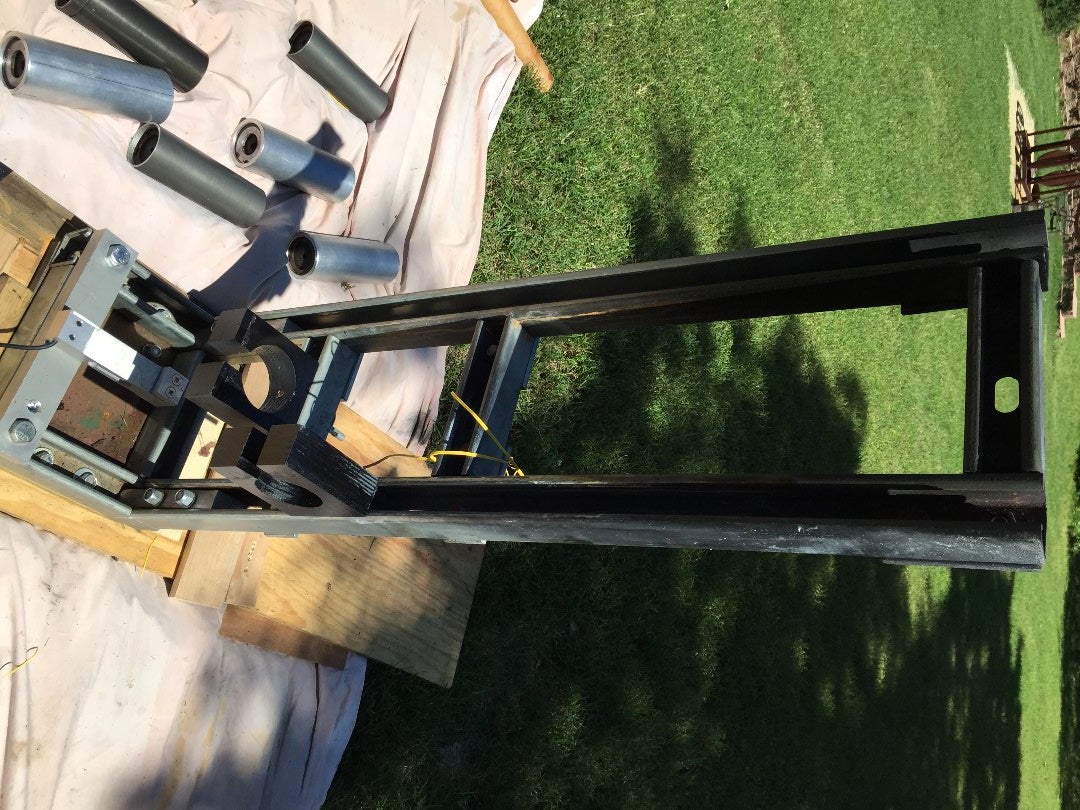

In addition to data collection a test stand is needed along with a load cell for measuring thrust and a pressure transducer for measuring case pressure. These last two are also available in a kit from the TC Logger website. You will need to buy or build a test stand. In the future I plan to release an Instructable illustrating how I built my test stand (see the photos).

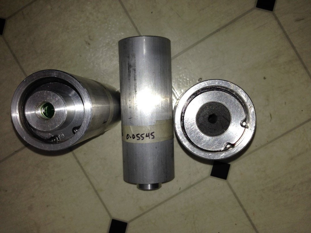

You will also need rocket motor casings designed for testing. The motors I made (see the photos) use graphite nozzles that have a convergent section (90 degree) but no divergent cone. They are numbered according to the size of the throat in 64ths of an inch. (e.g. a #25 has a 1/4" throat.) The forward closures have a 7/16" hole all the way though with 1/4" NPT threads tapped on the outward facing side. They are 54mm cases that work with standard 54mm casting tubes. The cases are made from 2" Schedule 80 6061-T6 Aluminum pipe. As you can see in the photos snap ring grooves are cut to retain the nozzle and forward closure just as with a standard 54mm motor (like one made by Gorilla or AMW.) They are designed to hold a single 3" 54mm BATES grain, with liner overlap on the nozzle (or in some cases nozzle carrier) and on the forward closure.

  1. Use single BATES grains for testing rather than the 2 or more grain setup the manual recommends

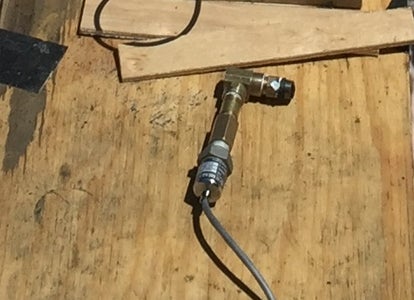

  2. Don't use the pressure hose that they recommend! Instead, use short solid brass tubing that keeps the pressure transducer close to the motor! The dead space can cause the pressure readings to fall behind the thrust readings. (See the photo of our pressure transducer and fittings.)
  3. Use fresh Teflon tape to seal connections between the transducer and the motor after each burn.
  4. Use a syringe to fill the pressure transducer and brass fittings with high-temperature grease. The syringe is to keep air bubbles out of the line and grease. Check the grease after each burn. Usually some burned grease needs to be removed and refilled after every 2nd burn. Care with this will keep the readings usable.
  5. Use neutral BATES grains (like the manual says) but don't stress over getting a perfectly square curve, and generally speaking don't use the TC Logger program to select averages. (On my PC it causes the shift key to be stuck down.) I use that only if I need to remove an ignition anomaly because of too much pressure from the ignition pellet.
  6. A pyrodex pellet is useful for ignition by e-match or initiator. Other pyrogens work well too but will not be discussed in this Instructable.
  7. Develop a system for naming files with burn data. We use the following system: The first two letters are the initials of the person who made the propellant. The next letters are the short name of the propellant. Then and underscore is followed by the "nozzle" number (e.g. #16 is 25/65" or 1/4".)
  8. Begin tests with the largest nozzle throat and work downward. Keep an eye on pressure to decide if you really want to test smaller nozzles. In our tests we use throats ranging from #12 (12/64") to #21 (21/64").
  9. A minimum of three good files are needed to generate a & n numbers needed by BurnSim (etc.) I recommend 5 or 6.

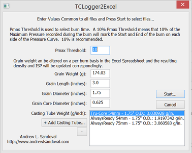

Simply run TCLogger2Excel.exe and enter the requested parameters. A brief explanation of each follows:
  1. Pmax Threshold - This is the percentage of the Maximum Case Pressure (Pc) used to determine burn time. Sutton (See figure 12.13 "Definition of burning time and action time") recommends 10% of Pmax for the "Action Time." Sutton further recommends using the "aft tangent bisector" to mark the end of the burn. We have found that with our small motors simply using 10% Pmax works most of the time.
    A link to the image from the Sutton book is available here:
    https://dallapiazza.files.wordpress.com/2013/10/figure-11-13-definitions-of-burning-time-and-action-time.jpg
  2. Grain Weight in grams - Weigh each grain prior to motor assembly. Put the average weight here. Later, on the worksheet for each burn, you can update the individual grain weight value for more accurate ISP results.
  3. Grain Length in inches - For a neutral, single 54mm grain this should be close to 3 inches if the core is 5/8". Adjust as needed for your purposes.
  4. Grain Diameter in inches - This is the outside diameter of the grain, or the inside diameter of the casting tube.
  5. Grain Core diameter in inches - This is the diameter of the core. We use 5/8" for all of our tests.
  6. Casting Tube Weight - This is the weight of the casting tube in grams per inch. This weight is subtracted from the Grain Weight for determining ISP.
Once these parameters are set, click on Start to select files. After files are selected the data will be imported into Microsoft Excel (2010 or newer). Each file will have its own tab and it's own thrust and pressure chart showing the Pmax line selected in #1 above. If there are 3 or more files an a&n worksheet is generated with the burn rate graph and trend line, and displaying the Burn Rate Coefficient (a), Burn Rate Exponent (n), and average delivered ISP.
NOTE: The values entered above will be saved in the registry and used as the defaults for the next run.

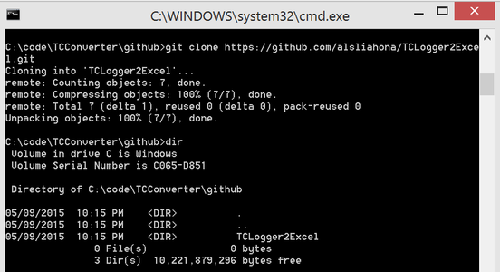

The source code is hosted on GitHub. Using a Git command-line client you can obtain the source by cloning as follows:
git clone https://github.com/alsliahona/TCLogger2Excel.git
Next download the Boost 1.57.0 zip file and unzip it in the same top-level folder where the TCLogger2Excel folder exists.
You can then open the TCLogger2Excel solution and build the project. Note that if you use a different version of Boost you will need to change the project settings to point to the new name.
