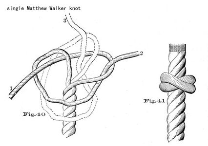

Step 8: Tail
The last part missing; the tail.
For the tail I used a piece of 3 twine sisal rope.
Which you can end with a knot called a single Matthew Walker.
(source knot image; text-book of seamanship 1891)
To fix the tail you can use wood glue.
By slowly rotating the rope in the hole you can fix the tail under a bit of pressure.
