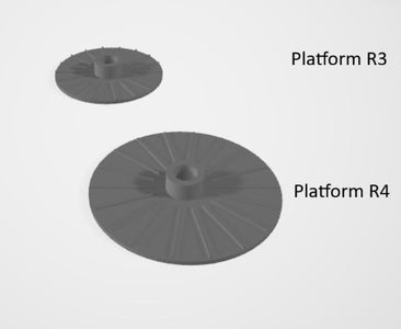

Step 1: Frame-Parts
Print out the parts in the attached file.

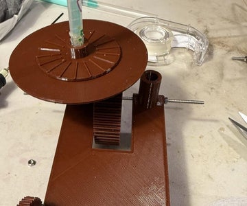

Step 2: Frame-assemble
Begin with the back wheels: clip both onto the chassis as shown.
Secure the large front wheel using the M3 threaded rod.
Then, insert the plastic axle into one of the two slots at the front of the chassis. The slot you choose will determine the rotation direction of the lantern’s outer layer. Secure the stick with an M3 nut and bolt. If necessary, use a heat drill gun to make a hole in the plastic stick at the correct position.
Install platform-R5 with the flat surface facing upward. Place platform-R3 on top as shown, then use double-sided tape to attach the two platforms back-to-back.
Next, assemble the platform wheel as shown and attach it to the plastic stick.
Install platform-R4. (Note: I don’t have a photo of this step, so the picture shown is from a later stage, but the setup is correct.)
Finally, cut the plastic stick to the appropriate height, then attach the top platform to its tip.
