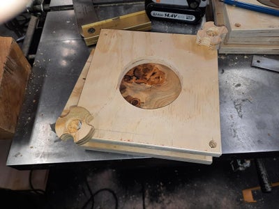

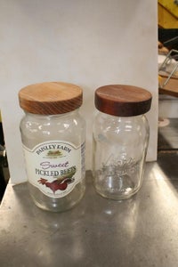

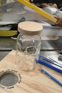

This is a simple jig to allow you to use your router to make wood covers for jar lids, regardless of the size of the factory lids.
Alternately, you can use it to make cup and glass coasters with indentations to stop the cup or glass from slipping off the coaster. You could add cork to the bottom, if you wished.
Previously, I just used double back tape and a piece of plywood with a hole sized for the lid I was making. The double back tape stuck a blank to the guide. You, then, routered a hole in the wood using a router template bit, which uses a bearing to follow the template hole [in the plywood] to make a hole the same size in the wood blanks.

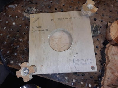

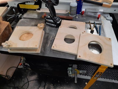

This jig still uses a piece of plywood with a hole in it cut to the exact same dimension needed to drop a given lid into, or sized for your coaster. Instead of tape or hot glue, it uses a second piece of plywood. The base and the template work together as a clamp to hold the work piece for routering the hole in your work piece.

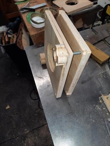

Clamping is accomplished via two simple clamps that are nothing more than two bolts permanently mounted in the plywood base, and two T-nuts mounted in homemade knobs, two commercially available, female jig knobs, wing nuts or even standard bolts to apply pressure against the upper, plywood template, causing it to squeeze a work piece between them.
The lower piece of plywood, the base, into which two bolts are mounted, is used for all the different templates (pint, quart, gallon, plastic, metal, Mason or Ball and coasters) you choose to make. The upper piece of plywood, the actual template, can be swapped for one with the size hole you'll need for a given jar lid or your coaster projects.
The top pieces, the templates, have two through holes that match the bolt holes on the base, so they can be lifted on to and off the base to create different sizes of lid covers. To reduce drag, when swapping template guides, the holes for the bolts are significantly oversized. For example, if using 1/4-20 bolts, the through holes in the templates are drilled to 3/8".
Both the base and top guide plate need to be big enough to allow your router to move around on the jig and to clear the whole area of the lid hole without running into the jig knobs. I was using a trim router (Bosch Colt), so was able to make my jig much smaller than I would have to if was using, for example, my 1-3/4 horse router.
Too, if you will be making one gallon lid covers, both the base and template will need to be significantly larger than for a quart jar.
One of the most important features of this jig is, it is a "what you see is what you" affair. That means, if you draw holes on your work piece sized for the jar lid cover you are going to make, when you slide it into the jig, it should align, perfectly, with the template.
To be a "what you see is what you get" jig, not only do you have to size each template hole to near the size needed to drop the lid in, you ALSO MUST use pattern/flush trim bits to cut the hole in the work piece. These are common bits and have the bearing on the top.
The bearing MUST be the same size as the hole the bit will cut, which is common for these kinds of bits.
The bearing will follow the template pattern you made. The bearing is held in place by a collet that fits tightly on the shaft of the router bit and is held in place by a set screw (usually an Allen screw). This allows you to replace the bearing from time to time.

Step 2: Building the Simple Jig
(1) Cut pieces of 3/4" plywood (AC, CDX or whatever you have) to at least 12" x 12" or larger, depending on the router you are using and the size of the lid you are making.
Cut as many pieces as you will need for templates
For example, if the base of your router is nine inches across, the bit is at the center, 4-1/2" from the edge. If you were to draw a circle sized for your lid cover, you'd want about five inches from the edge of the hole to allow the base to go all around it.
If you were doing a pint jar lid, twelve by twelve inches of base might be sufficient to avoid running into the clamp bolts. On the other hand, if doing a gallon jar lid, you would have to add a few inches.
Based on the foregoing, and if you have the room to store the jig and sufficient materials, making the base, say, 16" by 16" would allow you to use any router and to do gallon jars with room to spare.
If room to and materials are limited, measure and adjust accordingly.

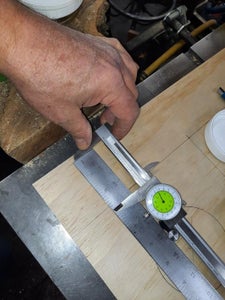

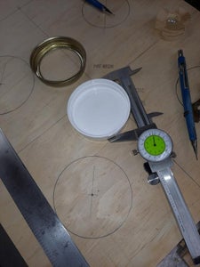

(2) Mark center of each template to locate the center of the hole you'll be cutting for the lid cover. Simply running lines from corner to opposite corner will give you center.
(3) Measure the jar lid for which you want to make a template. Calipers will give you what you need, or you can just lay the lid on a ruler, with one edge on the end of the ruler, then move the lid around for the maximum reading.
(4) Divide the dimension you got in step three in half and set your compass for that reading.
(5) Draw a circle around the center point of the X.
(6) Drill a starter hole inside the circle you just drew, then cut to the line of the circle using a jig, scroll or coping saw. Stay just inside the line, since it's easier to make the circle as close to perfect as possible using sand paper than it is using a saw.
(7) Using a spindle sander, a dowel wrapped in 80 grit or whatever method works best for you, sand the wood to bring the hole to the line drawn with the compass.
(8) Using a ruler or tape, mark in 1/2" from both sides of each corner. Using a nail, an awl or what have you, make a starter hole for drilling the guide holes.
NOTE: This step presumes all the templates and the base are the same dimension. If they are not, the holes will not align using this method. Instead, you will have to lay the base on top each template and use the clamp holes of the template to mark the drill point of each template.
(9) Drill a hole the depth of the bolt head into the base using a spade, Forstner or spur bit. You can mark the depth using tape.
(10) Drill on through the base holes just drilled using a 1/4" bit, and using the center hole left by the spur, spade or Forstner bit as a guide.
(11) For each template, switch to a 3/8" or 7/16" bit and drill the marked holes. Again, the larger hole allows the templates to slide over the base clamp bolts with relative ease.
(11) Slide the 1/4-20 bolt in through the bottom of the base, so that when pulled into place, it will be (approximately) flush with the bottom. You can use the clamp knob or bolt to pull the bolt into place.
NOTE: If your bolt head holes do not hold the bolt head with sufficient pressure to stop it from spinning, when clamping a piece, you can run a small screw on a flat side to obstruct movement. Hot glue or epoxy would solve the problem too.
(12) If you chose to make your own clamp knobs, do a quick Instructables search for "jig knobs" or "T-nut knobs" and several members offer steps on making them. If you went with commercial knobs, butterfly nuts or just 1/4-20 nuts, you are, now, ready to make lid covers.
(13) To make future use of the jig easier, I write on them the lid for which they will be used. Too, I mark the compass settings used to mark the holes on the face of the jig (see photo).

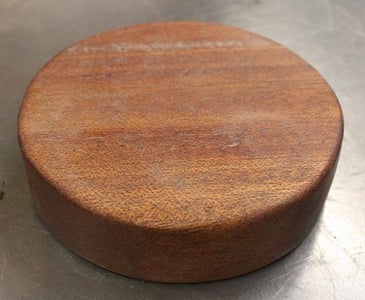

(1) Cut blanks for your lids from your chosen wood. They, of course, need to be cut down in both thickness and diameter, or width and length sufficient to allow it to fit in the jig.
I cut my stock to a bit over 5/8" thick, even 3/4" thick, which leaves plenty of room to sand the top and bottom of the cover.
You can cut the outer diameter before routering, or after. I recommend cutting afterward, because you may take off more than planned and there is no going back. Too, if the wood has a tendency to be brittle (e.g. will chip or break up when being routered), that problem is less likely to result in a destroyed project if you cut and sand to diameter after the piece is routered.
I make my walls about 1/8" thick, when completely sanded. However, you can make the walls much thicker, if that is your preference. Doing so would allow you to add more round-over on the edges, whether because that appeals to your tastes or you just want a better grip.
A lot of the cherry wood I used tended to blow out during the routering process. To reduce this, I saturated the brittle areas of the sides with either polyurethane or thin cyanoacrylate ("Super") glue.
Especially if using cyanoacrylate glue, insure you have plenty of ventilation. Not only might the process toss off visible smoke, it's nasty smelling and cannot be, in any way, good for your lungs.
If you chose to saturate the wood with polyurethane, some wood will suck it up like sponge. Just keep adding until it won't take anymore, or you run out of patience. Then, give the poly a couple days to harden, before finishing the project.
(c) It may help, if you're cutting brittle wood, to rough cut the blanks you'll be routering in at least a 1/2" oversized, then cut the outer diameter or other shape (e.g., square or diamond) after you routered the blank.
(d) If you do get a blow out, there is NO reason you cannot clean the blown out area up and glue in a replacement piece, the go back to the router stage again. This could even be done on purpose to add details to the lid cover.

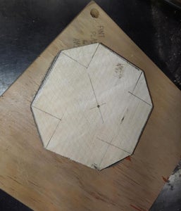

(3) To aid in aligning the work piece in the jig, layout the circle you are going to router on the piece of wood you are using, before installing it in the jig. Do this by setting your compass up on the set up marks you added to the jig face for the lid size you are using.
(4) Slide the work piece into the jig, align the drawn hole on it with the template. Then clamp the work piece in place by tightening the two clamping knobs.

(8) If your lid fits tight and stops at the bead, you can hand sand a slight bevel around the inside edge to let the bead seat into the lid cover.
(9) When you've completed the router work, and if you did not already cut the exterior to size, do so now. A bandsaw and drum or belt sander are ideal for this. The bandsaw gets it close and the sander makes it easy to bring the edge to a drawn line (circle).
(10) Finish sanding. 150 grit should be enough, if you are applying poly, shellac or lacquer.
(11) Use hot glue, epoxy or even double back tape to secure the lid in the cover.
(12) You're done - use your new Rolls Royce jar lid cover.
